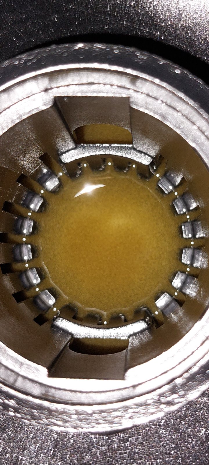

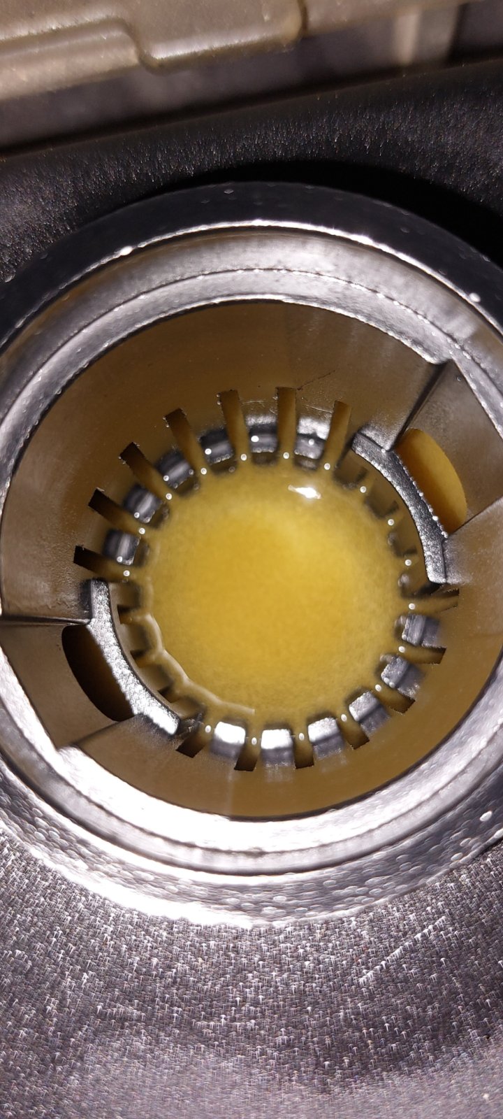

Hello again!
My car is C5X7 2010 2.0hdi 103kw exclusive.
I have done suspension bleeding procedure 3-4 days in a row but the air keeps reappearing in Lds tank.
My procedure:
1. Start the engine
2. Setting suspension in high position
3. Setting suspension in low position
4. Lds cap off
5. Steering wheel slowly 5-10 times from lock to lock.
6. Engine off, ignition on
7. Depressurise suspenion using lexia
8. Waiting for all the bubbles to disappear
9. Lds cap back on
10. Start the engine and repeat everything 3-4 times until there is barely any air showing in lds tank.
After there is no more air, I drive my car for about one day. After one day I do the same procedure to check for air and its there again. So I do same procedure again but air keeps reappearing.
Reason I do this is because after 1 day of driving car losses its smoothness. I can definitely feel the diffrence when there is no air in the system.
There is no any lds leaking anywhere.
What could cause air in the system to reappear?
Thanks 😊

So Marc,
I have done the procedure 4 times in a row. I could definitely see some extra larger bubbles coming up when turning steering wheel lock to lock while system is depressurised.
I will drive the car today and do this procedure tomorrow again in hope no new air bubbles reappear.
One quick question.
Does it matter if I remove lds cap while car is in high setting and then put it in low and depressurise the system or should I depressurise the system first and then remove lds cap? Or it doesn't matter?
Also when I'm done with bleeding I put lds cap back on and then put car to normal setting. Should I remove it once the car is in normal setting again and then put it back on? Or this also doesnt matter?

So it's me again.
After about 3 days of driving I have depressurised suspension and there is plenty of air again.
What should I check first? Someone mentioned power steering? How can I check if power steering is bringing air to the system?
x 6945
Re: Air in suspension system c5 x7
The bleeding system covers the power steering - the same LDS fluid from the same reservoir is used for the electric power steering. You will find that 'fizz' will go after a few minutes.
Have you checked your steering rack pinion lately? The X7s suffer greatly from rusting pinions on the rack, leading to destruction of seals and further penetration of rust internally. This is a common fault (I was on rack number 3 before selling mine on). If you have the start of this problem, there may be a small amount of air getting in.
