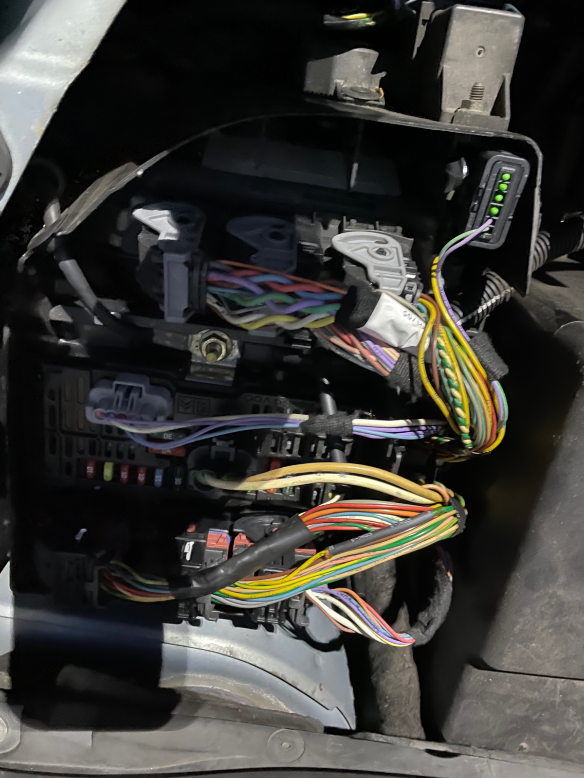

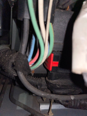

Hi. I am trying to fix my daughters C4 blower - really need it working now winter is almost upon us.
There isnt any power getting to any of the feeds to either the blower motor or the rotary control switch.
I have checked the fuse which is ok. So I am guessing that there must be a relay somewhere for this?
My question is where would that relay be?

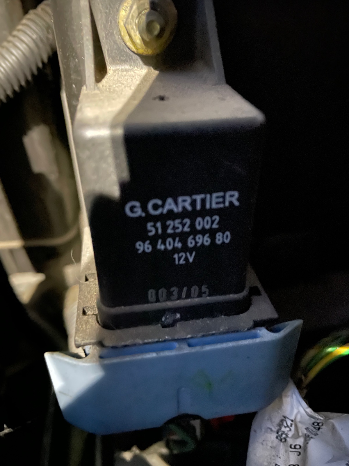

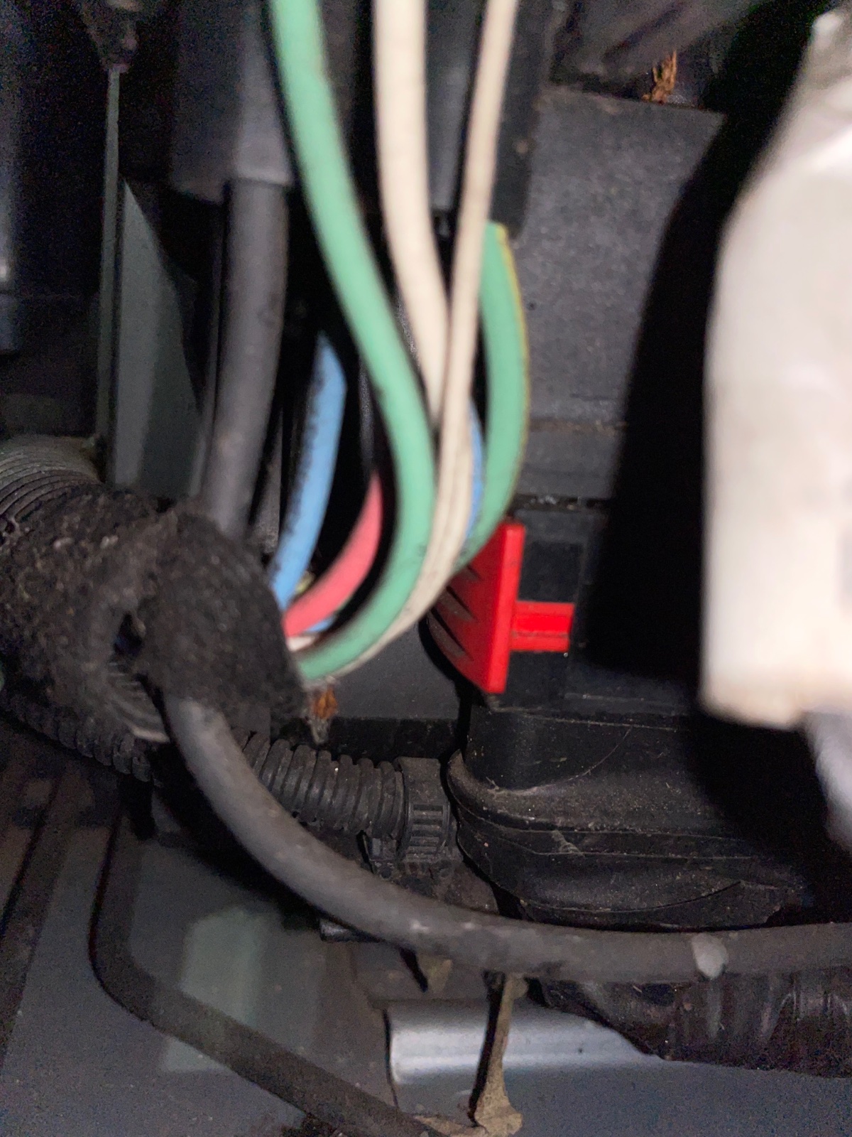

I took a picture of the only thing that looks like a relay but not sure also a pic of the wires underneath whatever it is along with the fuse box - all in the engine bay.

I can tell you the big relay in the last pic is your glow plug relay.
As for the blowers, from memory the power supply comes from the under bonnet fusebox.
Would need to check a diagram but as said above need the VIN or reg to get this as there are several different versions. A/C or not? automatic climate control or manual? etc.

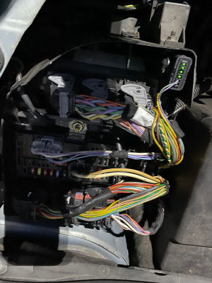

The relay is part of the under-bonnet fuse box/BSM and is not serviceable. On our 2005 C4 first the fan started playing up on high speed, then it failed completely, and some time later the car came home on a tip tray. That made the cost of a new module more bearable.

I am surprised that the relax is integral with the fuse board and isn’t serviceable. I might have a go at putting a separate feed through once I find the right wire to put the juice into!!!

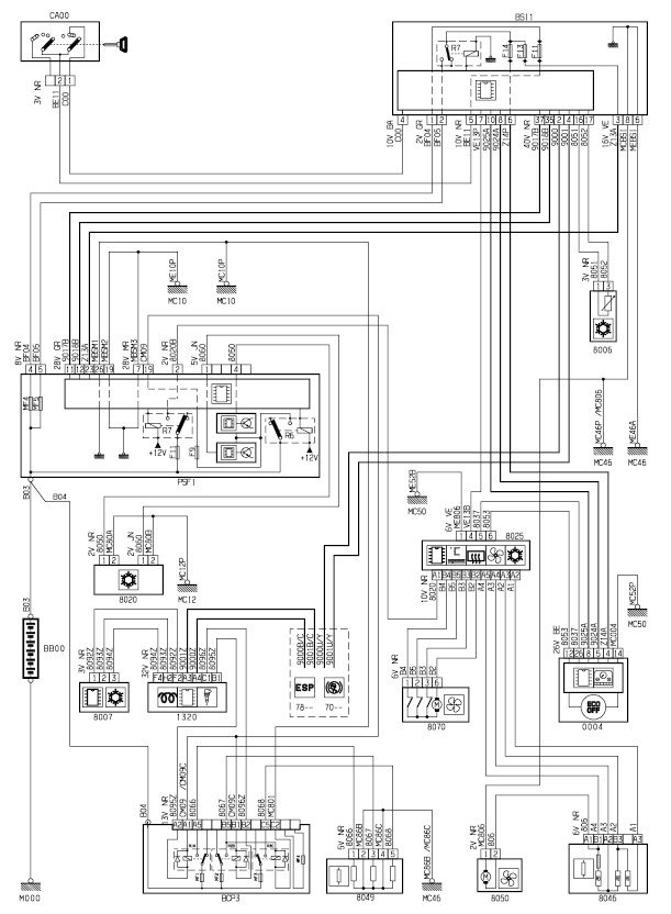

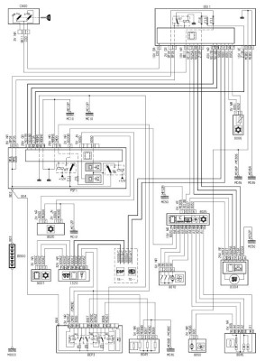

Diagram For A/CSpinup wrote: 19 Oct 2022, 13:34 is there someone who can guide me as to how to get the wiring diagrams and location of fuses etc please?
Spinup
- Posts: 9
- Joined: 12 Sep 2022, 07:44
Re: 2005 Citroen C4 relay location.
Many thanks wheeler. This should help me a lot
