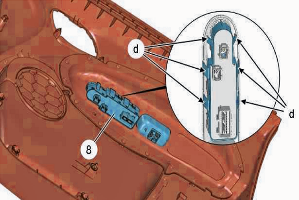

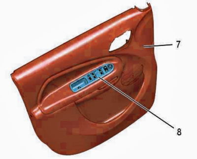

1) The driver's door armrest control panel (you can lift this out with some trim removal tools by wedging the clips to release it upwards). You can then check the wiring plugs are firmly inserted. They can work loose with all the door opening and closing over time. This happened to me on a new car!

The module is seen here at (8)
... and from the underside once lifted out - you can see the various plugs I was referring to that can become loose.

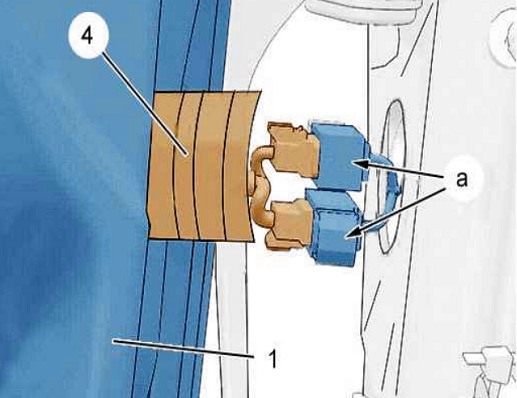

The harness clip / grommet should separate:

Well spent 4 hours on picasso yesterday and decided only way to remove harness is to unbolt door hinges
and slide door away from jamb exposing the connector blocks.

well i have finally got around to fitting the door harness! and am pleased to say window, mirrors, central locking are now ok.
i ended up disconecting all the wiring plugs in the door and then withdrawing harness out of the door, this then gave me enough
space to pull connector blocks out of A post, i put 2 cocktail sticks behind connector blocks to stop them disapearing, although
i'm sure you could retrieve them easily enough. had to re initalise window by lowering all way down then moved it upto top
then held on to switch for a second, and that sorted it! hope this may help others with similar symtoms
