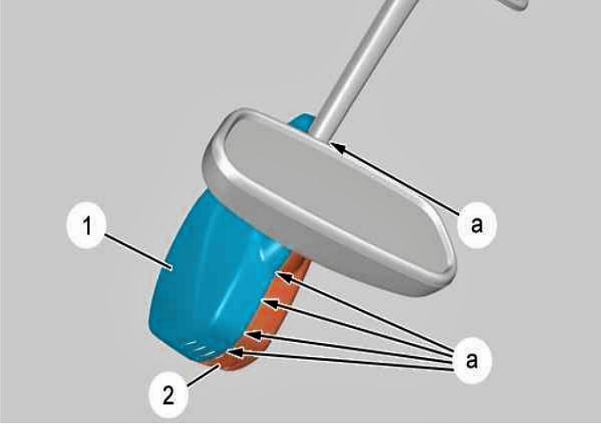

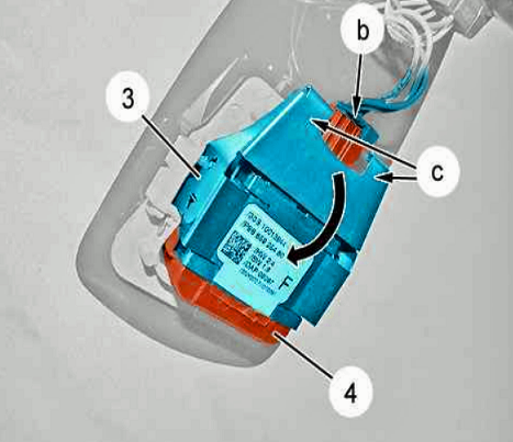

Here you go:
Detach the half-shell (1) (at "a") using trim removal tools.
Detach then remove:
The half-shroud (1)
The half-shroud (2)
This will expose the sunlight / rain sensor - but don't remove this again as it can become opaque causing loss of functionality / performance!

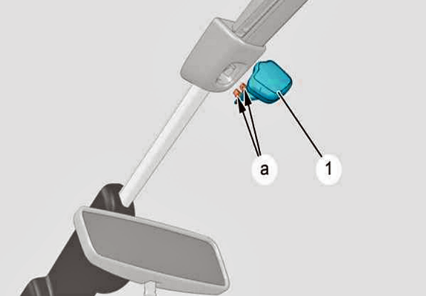

Do you have the same instructions for the tiny mirror (optional extra) just above that?
It's the part just popping its head out on your first picture in the top right corner.
I think it's called a 'child mirror' (trim part - 98052612 BJ or 8143 RS, and mirror part - 8153 AQ)
It's actually that part which hasn't been put back correctly and is rattling around.
It may be under the instructions for removing the sun visor trim (98018898 BJ), as the 'child mirror' is an extension from that down onto the windscreen, which then extends down further to the rear view mirror.

You just use a trim tool to release the clips shown at 'a' in order to release the child mirror. The unit holding it in is called the sun visor module. It's possible knowing windscreen fitters, they may have broken off a clip when removing it and if this is the case, get them to provide a new one - they have insurance for this kind of thing. I got mine to cough up for a new sensor Rain / sunlight sensor at £260 after having my C5 windscreen replaced which ruined the performance as the sensor gel went opaque. They'll argue with you but don't take no for answer if this is the case.
The child mirror is part 8153AQ and is £36.25 from Citroen in case it is this.

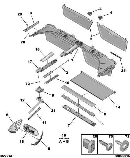

It rattles and I suspect they have not put the retaining screw back in, shown as number 72 in this parts diagram.
The whole mount moves around from the window, not just the cover section.
I wanted to know how to remove the child mirror and trim to be able to check

I've managed to sort this, this morning.
I stripped the top trim back, and found that the windscreen company had put the top section to the window with the screw in it, but appear to have completely forgot the screw it at all, so it was fully loose.
A quick screw with a torx bit and it secured to the window.
All sorted.
