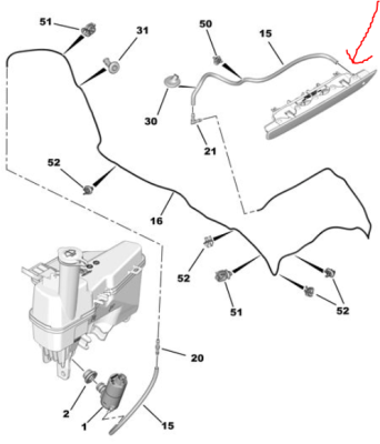

Furthermore water is dripping from the rear top brake light into the cabin. How can this be fixed? I took the seal off on the backside of the light and removed the water but I don't understand how the water could enter the light.

The rear screen washer pipes run via the rear high level brake light, so if the pipe has worked loose, then water will start getting in. I would check to make sure the pipe is securely fastened on:

Thank you. The liquid looked like water and it didn't smell like washer fluid. I'll take the seal of again and run the washer to see if the light is filling with fluid.

Either that or if it has been raining you may have a crack in the lens - look around any screws that secure the lens it for a spider web-like pattern. This can be a tress crack caused by the screw over time. A few vehicles suffer with this and Citroen simply replace the lens cover.

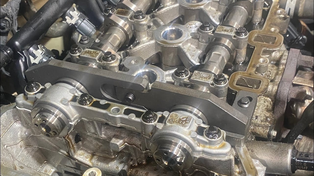

Yes this makes sense. I also think that he told me to do it earlier due to this issue. I looked at the belt before buying the car through the oil filler cap. It looked a bit rough on the rubber like it had small pits in it. The size of these pits is around 1x1mm and they're covering the whole belt. I'm assuming the belt isn't 100% smooth from the factory. The dry belt I did on my C3 had some pits like this probably from the manufacturing process. This said the belt didn't have any cracks so I would assume it's good for now. I would like to do the belt early rather than the belt failing and giving me much bigger expenses. The belt seems rather straight forward to replace. But I've seen that there is two versions of this engine one has a plastic rocker cover which when removed is exposing the camshafts. The other model I think it's called 1.2 Puretech GDI has an extra metal part before the camshafts which is also sealed to the cylinder head with a RTV gasket.
On both models the plastic rocker cover is sealed with a rubber gasket.
The model with the extra metal part: The model where the camshafts are exposed after removing the plastic rocker cover: Do you have a manual for this procedure?

I removed intake, rocker cover. The intake was hard to get out but I removed the engine mount and managed to pull the engine a little forward to get the intake out. I didn't remove the sump but probably should to check the oil pickup for rubber. The crankshaft gear just came out easy when the large bolt on the crankshaft was removed. Also the alternator was not in the way it is pretty high up over the ac compressor. It's pretty accessible from underneath. The only issue I have is that I don't know the correct tightening torques which PSA is advising. I tried googling and found a Portuguese video on YouTube which states the following tightening torques which I used.GiveMeABreak wrote: 05 Oct 2022, 12:13 I don't, but the Transmission, engine - gearbox assembly, alternator and oil sump need coming off from what I can tell. It's quite an involved job....
The tensioner and idler should be tightened to 20 Nm.
The crank bolt to 50 Nm and 180 degrees.
The dephasers to 20 Nm and 120 degrees.
The 3 crankshaft pulley bolts to 30 Nm.
The metal part between the head and the rocker cover to 10 Nm.
The cover for the inspection hole on the side of the engine, rocker cover and intake bolts to 8 Nm.
I hope this information will be useful for someone doing the same job in the future.
