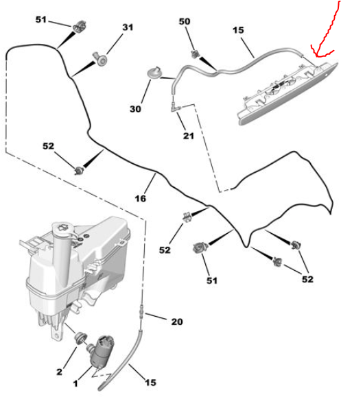

Furthermore water is dripping from the rear top brake light into the cabin. How can this be fixed? I took the seal off on the backside of the light and removed the water but I don't understand how the water could enter the light.

Every 175000 Km / 10 year(s) for your vehicle under 'Normal' conditions or Every 165000 Km / 10 year(s) for 'arduous countries / use.
The rear screen washer pipes run via the rear high level brake light, so if the pipe has worked loose, then water will start getting in. I would check to make sure the pipe is securely fastened on:

Thank you. The liquid looked like water and it didn't smell like washer fluid. I'll take the seal of again and run the washer to see if the light is filling with fluid.

Either that or if it has been raining you may have a crack in the lens - look around any screws that secure the lens it for a spider web-like pattern. This can be a tress crack caused by the screw over time. A few vehicles suffer with this and Citroen simply replace the lens cover.

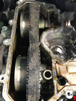

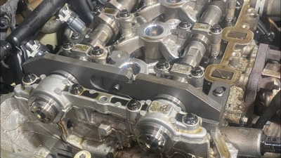

Yes this makes sense. I also think that he told me to do it earlier due to this issue. I looked at the belt before buying the car through the oil filler cap. It looked a bit rough on the rubber like it had small pits in it. The size of these pits is around 1x1mm and they're covering the whole belt. I'm assuming the belt isn't 100% smooth from the factory. The dry belt I did on my C3 had some pits like this probably from the manufacturing process. This said the belt didn't have any cracks so I would assume it's good for now. I would like to do the belt early rather than the belt failing and giving me much bigger expenses. The belt seems rather straight forward to replace. But I've seen that there is two versions of this engine one has a plastic rocker cover which when removed is exposing the camshafts. The other model I think it's called 1.2 Puretech GDI has an extra metal part before the camshafts which is also sealed to the cylinder head with a RTV gasket.
On both models the plastic rocker cover is sealed with a rubber gasket.
The model with the extra metal part:
The model where the camshafts are exposed after removing the plastic rocker cover:
Do you have a manual for this procedure?
