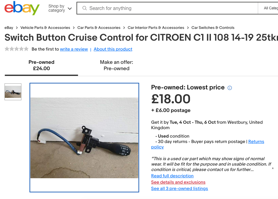

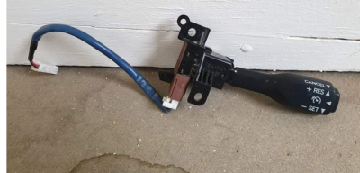

It looks like it's the standard cruise control stalk that's been fitted to every single Toyota since time began...usually located at 4 0'clock behind the steering wheel
Dunno if you'd need Diagbox or Toyota Techstream to configure the car for it
