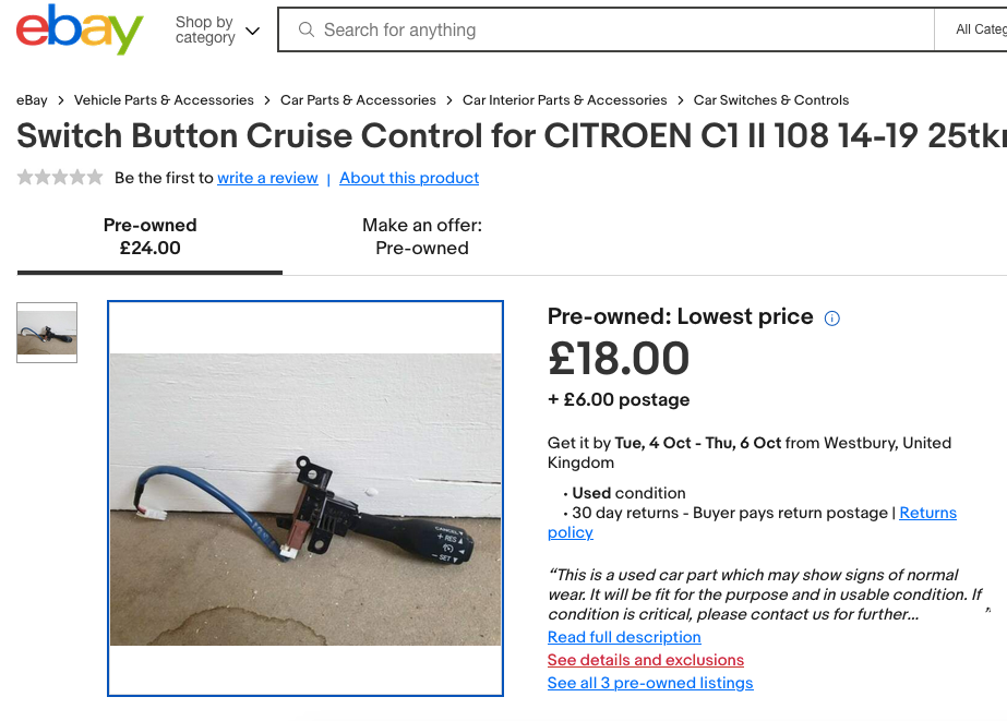

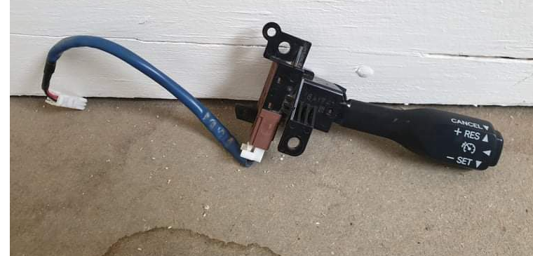

Re: Retrofitting cruise control on Citroën C1 1.2 Puretech 2017
It looks like it's the standard cruise control stalk that's been fitted to every single Toyota since time began...usually located at 4 0'clock behind the steering wheel
Dunno if you'd need Diagbox or Toyota Techstream to configure the car for it
