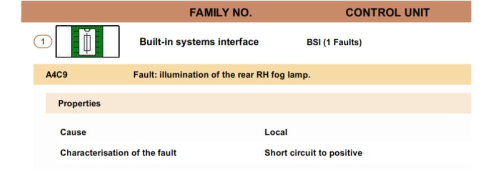

I've a new dash warning saying my foglights are faulty.
The front ones work okay (eg when turned on with the LHS stalk)
Diag says it the rear RH one code A4C9, so I assume the one of the tail gate ones either side of the number plate
More worrying it says the fault is "short circuit to positive"

The good news on the rear fog lights is that I now know how to turn them on and they both work.
The bad news is that the car still thinks there is a fog light error as does Diag.
The last thing I did was pull the air cleaner out to change the auto transmission fluid, so will check if I have disturbed any wiring / connectors.
Any other hints ?
