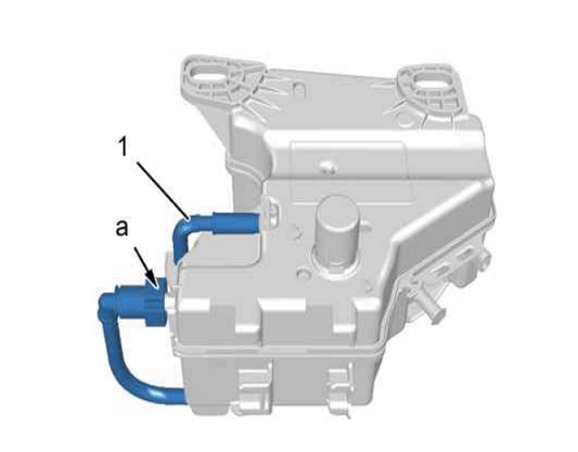

Refilling
Raise the vehicle, wheels hanging.
Remove the protection on the fuel additive reservoir.
  • Uncouple the pipe (1) (at "a").
  • Couple the additive container to the tube (1) using the adaptor and pipe (with tap) from the filling kit.

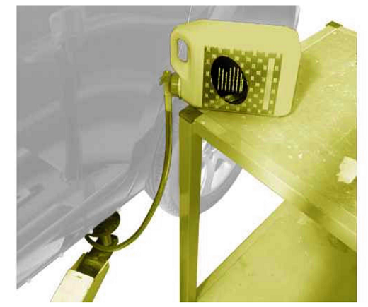

  • Connect the empty container to the filler tube , suspending it on the holder
Place the additive drum at a higher level than the additive reservoir.
1 litre can of product:
Use the retaining net provided in the kit
Pierce the additive container (At the place indicated by a triangle on the container)
Add the quantity desired, depending on the value (quantity of additive consumed) read via the diagnostic tool.
3 litre can of product:
Open the valve located on the click-fit filler pipe (If necessary, tilt the can to facilitate the end of filling)
When all of the fluid has flowed out, release the click-fit filler pipe .
Click fit the additive reservoir filler pipe (1).
Refit the protection on the fuel additive reservoir.
