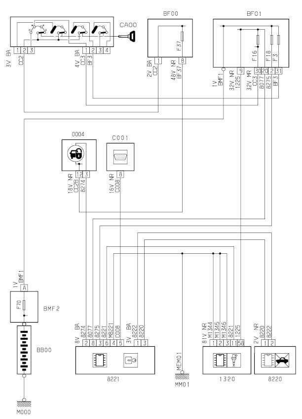

Pin 6 on the immo box appears to be the only single connection to the injection ECU.
Here is the diagram.
This vehicle does not use CAN at all, It is not even multiplexed.

Apologies for the typo wheeler, and a big thank you for the schematic.
That clarifies things for me now.

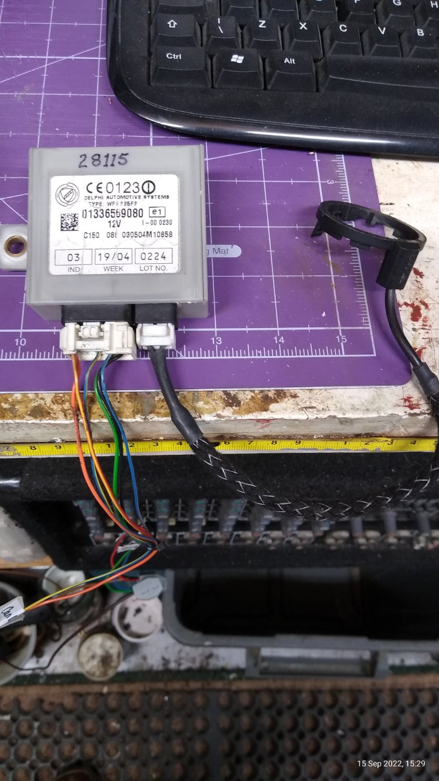

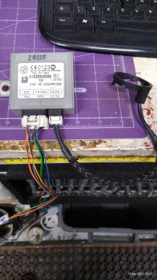

I have enclosed pics of the immobox and transponder coil, with I think will be 8208 and 8209 in PSA schematic terminology.
If you have a schematic that shows these two components, that would be great!
Thanks
Your diagram is close but not quite appropriate to my situation.
Thanks
wheeler
- Posts: 7927
- Joined: 21 Sep 2002, 19:07
- x 1056
Re: Citroen Jumper /Relay (2005)
8220 = Transponder Aerial
8221 = immo box
1320 = injection ECU
C001 = Diagnostic socket
0004 = Instrument panel (for padlock lamp)
What makes you think this diagram is not correct?
Im not sure how you know this as the diagram i posted above doesn't show any wiring colour's, only the wiring codes are there & the connector colours which are an 8 way white & a 3 way white on the immo box, the same as whats on your picture??welldigger99 wrote: 15 Sep 2022, 19:14 Thanks wheeler.

Success!
Having learnt from my earlier misinterpretations I have now got the immobox interfaced with the ecu on the bench, using the schematic provided by wheeler.
Lexia (and PP2000) are now happy with my setup.
I had earlier programmed the immobox file (93LC56B), with a new pin and prepared the ecu with a virgin 5P08 eeprom file.
My new pin was successfully recognised allowing me to progress to key programming.
I have an ID48 transponder and key fob on the way, so this will be the next task.
The vehicle is currently working with an "immo off" donor ecu, and my ultimate aim is to reunite the original immobox and ecu with the vehicle, in a fully working state.
Thanks again for all the advice in getting me to this stage!
