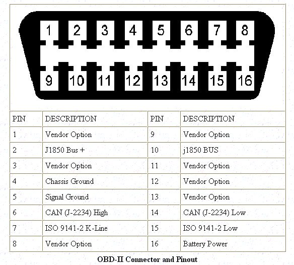

Presuming the pin out for the plug on the board is the same order as the pin out for the plug that goes into the diagnostic socket I've done a little research for you. I pulled up a pinout diagram of the OBD2 socket:
Then ran an algorithm to rotate the pin allocations emulating the plug being rotated, and compared that to the original allocations:
To me, who is more clanky than sparkytronix, it looks as though you might have gotten lucky, with the exception of pins 2 + 15 being reversed, putting a J1850 bus hi to the ISO 9141-2 Low, there's no major damage causing stuff I can see there. There was a worry in my mind about pin 16 on the socket which is battery voltage, going somewhere it wasn't meant to, like to a data line. But it's "dance partner" in the rotation is an optional pin that may or may not be in use, , so I'm relatively optimistic that you haven't done anything that prompted the angry pixies to let the magic smoke out of the ECU network. I'd go through the battery off procedure, power down the vehicle completely for a few minutes, during which time you can check every fuse, then once you're done with the fuses, reconnect the battery and power the vehicle up again and, fingers crossed you'll be golden.

Yes exactly i was comparing the same reverse diagram before, and later at night could not sleep and went back in the garage, so when i put ignition on there is a clicking noise coming from the BSI at an interval of around 5 or 10 seconds, so i took my Thermal camera to double check the fuses (I removed them manualy also), so first i tested the fuse box inside the car and seen that the shunt fuse have higher temperature when i remove the key, but i quess that is because the BSI takes power for aditional 3 minutes from the battery until it goes to sleep, than i went to check the fuse box under the bonet and fuses seems ok BUT, under the fuses there is one relay of the BSI labeled YH119 S0438 (i will upload picture from the exact relay) that have very high temperature on the thermal camera when i put ignition on, now i am not sure if that supose to recive electicity when ingition is on or that might be the problem.Jay-Bruce wrote: 31 Aug 2022, 11:47 Presuming the pin out for the plug on the board is the same order as the pin out for the plug that goes into the diagnostic socket I've done a little research for you. I pulled up a pinout diagram of the OBD2 socket:

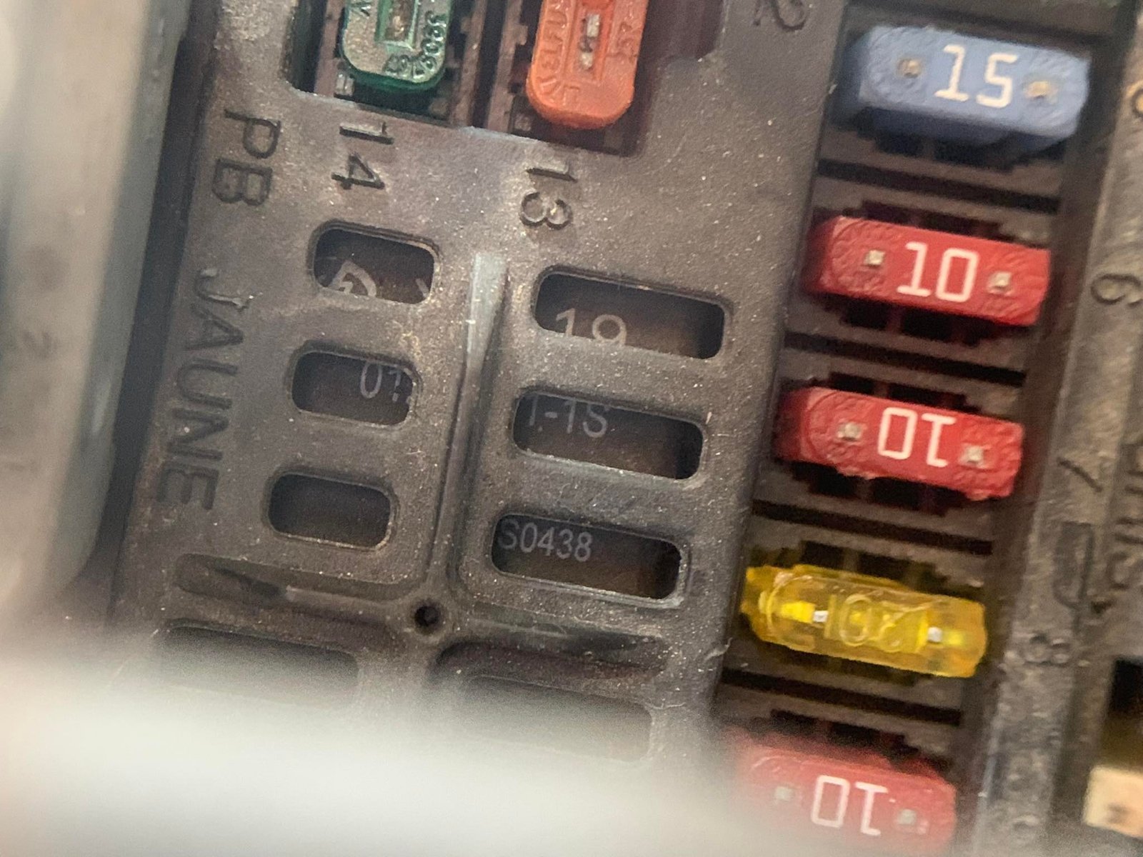

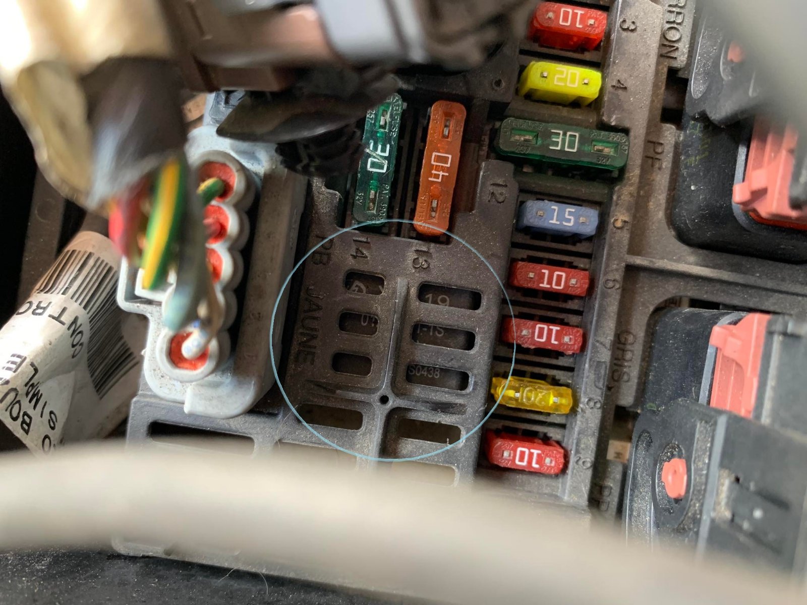

Here is the picture of the relay that shows high temperature when i put ignition on:

The relay circled is on the BSM (under bonnet fusebox). The BSI is inside the car.
I would also agree with the above, I would say (without getting hands on with it) that it is more likely the relay is being told to do that rather than the relay being faulty. The BSM is not a coded part so can be swapped from another same spec model mo problem. Its very possible that the BSM electronics have blown but I would think that the actual soldered on relay is fine. Most automotive 4 & 5 pin relays are not polarity specific
Do you have power at the diag socket??

Before going to all that expense, pull the BSM (under bonnet computer controller), take a photo of the fuse layout and use a very fine nail file to clean ALL of the fuse beds. We have all manner of stupid with our car a few years ago and it turned out the fuses had got damp, grotty connections and chaos ensued
I did the above cleaning and all became well again.
However, you CAN (as suggested) pick up a BSM fairly cheap so long as the numbers match yours. I can't honestly remember WHICH numbers, but I imagine one of the chaps will happen along to help
