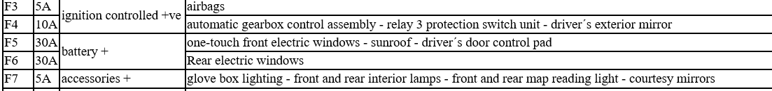

Hi all, I have added a subwoofer to my car and I need to get 12V to turn on the sub amp when the engine is running. I tried F4 and F7 fuses(with a fuse holder add-a-circuit), but neither worked(0V on the multimeter). Is there another place from where I can get 12V when the engine is running?

Assuming this is a C5 X7, G39 in fuse box A is the designated (factory-installed) amplifier circuit - 30A fuse so should give you 360W?
