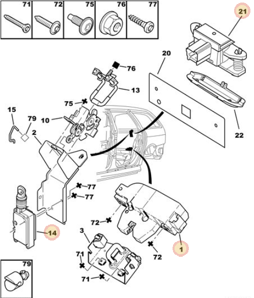

Hi
As the title say's the switch/solenoid has obviously packed in.
Where is the best place to get a replacement or is the original one repairable ?
cheers

Hi Ken
Have a look at the diagram.
(1) Is the Tailgate Lock, part: 871986, £59.80
(14) Is the Locking Actuator, Part: 661527, £167.90
(21) Is the Rear Tailgate Contactor Switch, Part: 6554F1, £28.28
All are available VAT inclusive from Citroen. Let me know if you need the part for something else on the diagram.

Why do you think the switch/solenoid has obviously packed in? The Mk1 and Mk2 C5 Estate rear windows were notorious for the wiring failing. I had a struggle finding the fix for this and had to resort to the Wayback machine.
https://web.archive.org/web/20210210234 ... ningc5.pdf
