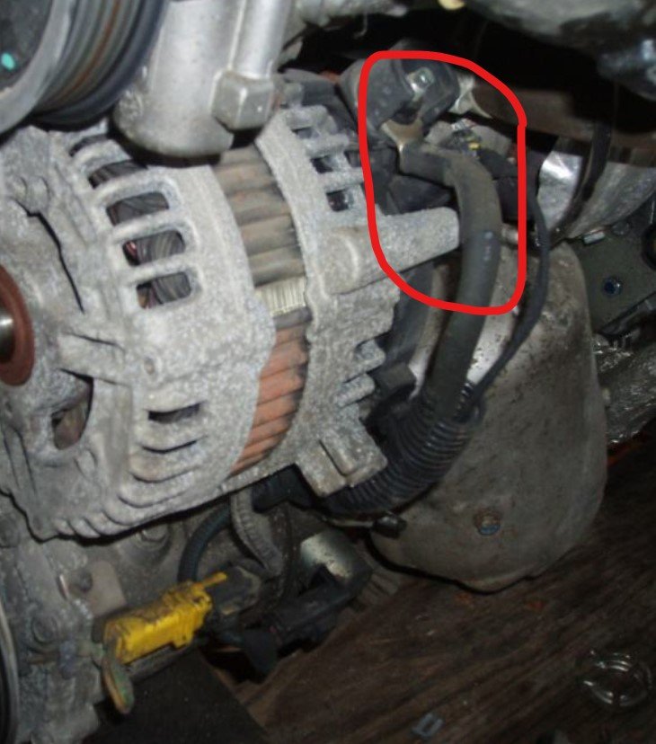

So, I have degreased and washed down my 407 V6 engine lots of times in the past with no issues but this time things went a little bit wrong.
Engine was cold, sprayed degreaser to get rid of some oil leaks in the front, washed it down and went away for 5 minutes.
Came back and noticed some smoke and the start of a fire.
Quickly disconnected the battery and then doused with water (thought about using the electrical power fire extinguisher I had just bought but had hose at the ready and plan B was too far away)
On inspection, seems the alternator output cable (which bolts to the top of the alternator - why ? ) had "dropped" closer to the alternator body and the water etc had created enough of a short circuit to get the cable plastic on fire.
Thought about taking half the car apart to change it but just pulled the cable up (and zip tied it to create a bigger gap) and since the car started and had 14.4 v on battery, no real damage done (for now at least)
Some not so happy snaps showing the issue (not my car)
407 - ways to get smoke and fire after wash

Just to add, am surprised by the original post - wouldn't have thought possible to get 12 volts to short through water
