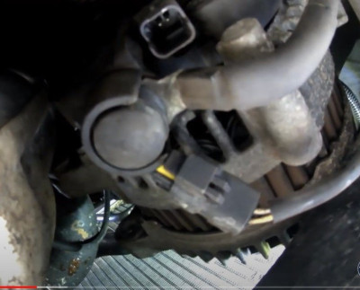

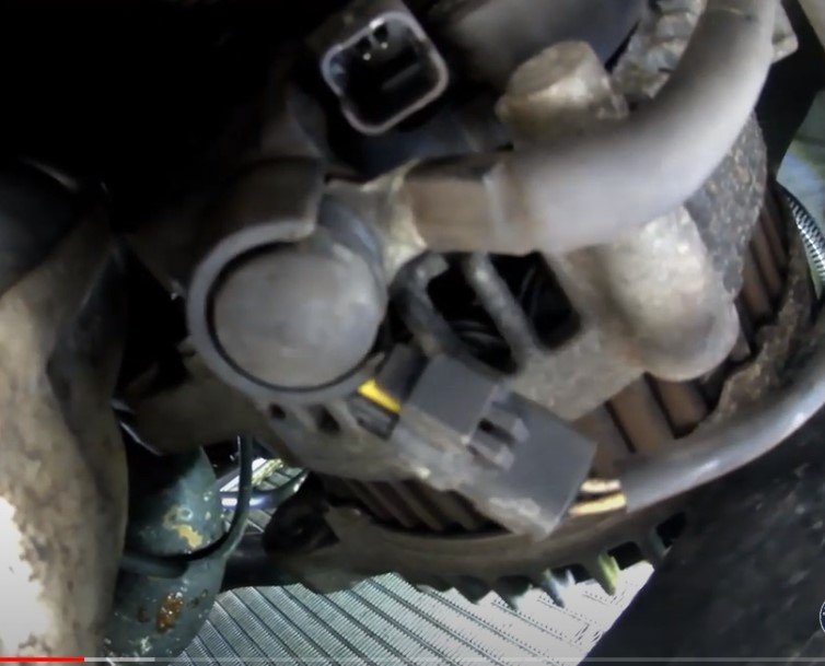

On inspection, seems the alternator output cable (which bolts to the top of the alternator - why ? ) had "dropped" closer to the alternator body and the water etc had created enough of a short circuit to get the cable plastic on fire.
Thought about taking half the car apart to change it but just pulled the cable up (and zip tied it to create a bigger gap) and since the car started and had 14.4 v on battery, no real damage done (for now at least)
Some not so happy snaps showing the issue (not my car)
