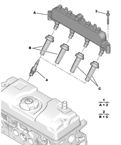

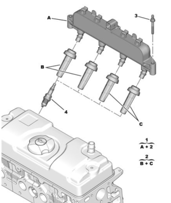

So the plugs are item (4)
Part number: 1632745480 and the following are all ok:

So plenty of choice. I can't speak for the other brands, but the above are all listed on the official parts for your vehicle.
