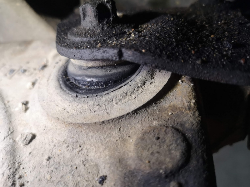

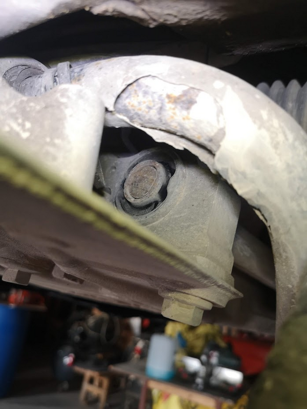

It took me a whole month to get it on my lift... It seems that the noise isn't that annoying after all
I inspected the control arm bushing, they were a bit worn but not moving. The knuckle bushing on the end of the control arm seemed OK as well.
But I seem to have found the culprit - lower ball joint or even as to say a bearing. I did not find a way to check the upper ball joint unfortunately but I will check it when I'm going to replace the bearing. The sway bar end links are also on their way out - no play yet but I'll change them anyway.
I made a couple of small clips, can anyone comment on the upper control arm bushings condition?
https://photos.app.goo.gl/BsKZnifGPxnN3n2R8

Hey! It turned out to be the upper ball joint on the right side. Couldn't get any play out of it as it seemed but the movement of the lower bearing (up and down) showed that the upper joint was worn. It gradually got worse so I ordered the specific tool for the ball joint and the replacement wasn't that difficult. No noise!
