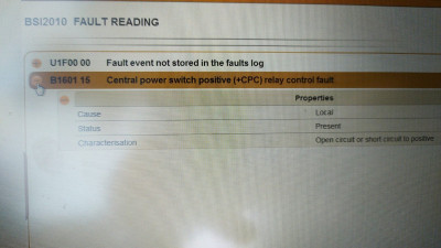

The "Electrical circuit failed: have your vehicle repaired" error pops up every time I start/turn the ignition on.
I ran a diagnosis with Diagbox and I get: B1601 15 -> Central power switch positive (+CPC) relay control fault.

Here is the fault descriptor for this code, but post up your VIN (automasked on post submission) so I can check this is the same for your vehicle, just to make sure.
Fault Code: B1601 15
Description of Fault: Central power switch positive (+CPC) relay control fault : Open circuit or short circuit to the plus. The control is active even though the control copy is inactive. The control line of the central power switch positive (+CPC) relay is considered active when its voltage is lower than 2,7 V
Fault confirmation time: 1 seconds.
Conditions of activation of the diagnostics: The following conditions have to be met:
- BSI triggered
- LIN networks re-awakened
Conditions for Fault to clear: Control copy active
Time of disappearance of the fault: 1 s
Downgrade Modes whilst Fault is active: None, but this may trigger the "SERVICE" warning lamp Warning message and / or an audible warning.
Symptoms: No supply of electrical components.
Suspect Areas:
  • Connectors
  • Electrical harness
  • Built-in systems interface
  • Supplies protection and management unit
So I would first check and test all the fuses in the supplies protection management unit as these power various equipment, but if the garage have tested it and are confident, then I can't do much more than provide the code description for this fault for you.
