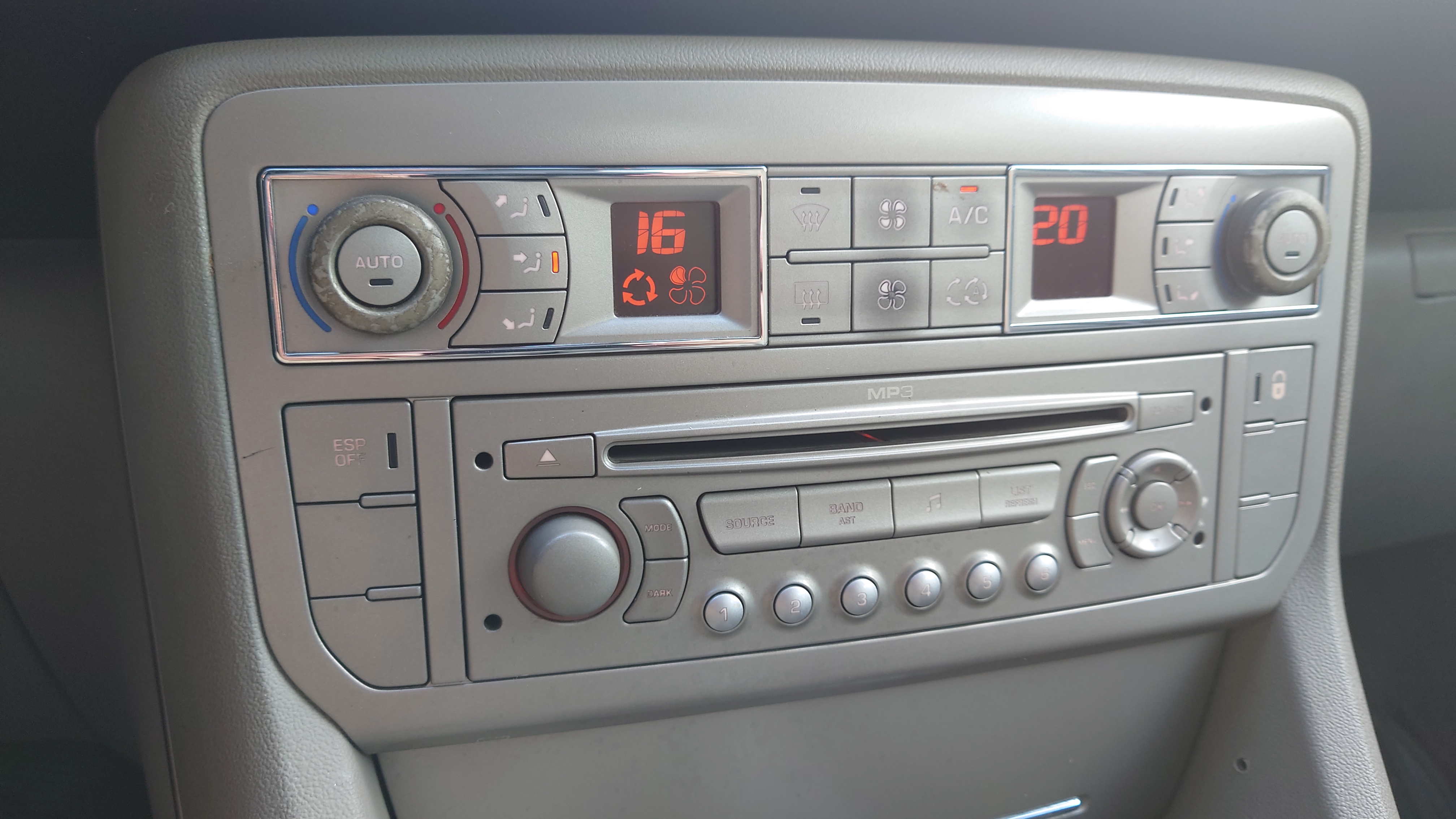

Hello, I'm a proud new owner of a C5 X7,
After reading on here, and contemplating on what to do,
I have decided to stay with original equipment and only upgrade the existing RD4 unit and replace the busted display (pixels are burned out)
With the RD45 which includes Aux and Bluetooth support..
Now from what I can see, there's either Chinese clones? of the RD45 on AliExpress,
which forum peeps have reported to successfully install them, and that they work,
Or I can go for Original 2nd hand ones from eBay sellers..
Which one should I go for?
taking into consideration that Audio Quality and Unit reliability is important to me,
and that in my country there isn't any fancy features like NavMaps..
My VIN is:
Also one final thing, my current unit is I guess rare in that it is colored gray, and not black, as part of the 2 tone interior

Some, if not most of the RD45s on Ali and other sites are not clones, but are "recycled" units that have been pulled from new vehicles which were being upgraded.
There are several different front panel versions for these radios, and some are rare or non-existant on an RD45. For my conversion, I transferred the original RD4 plastic panel to the RD45, but this requires trimming the plastic and modifying some metal tabs to fit.
Also be aware that most European RD4s have dual antenna inputs, but most of the available RD45s have only a single antenna connector (ignore the green connector on the RD45, it is not functional).

The actual trim colour for the interior is called 'MATINAL ANODIZZATO'. Of course if you have decided to not just replace the screen which is likely faulty , and have instead opted to upgrade to RD45, then you'll need a different screen compatible with the RD45 as well as the RD45 unit itself and it will need VIN coding and configuring. You also may not have the microphone wiring available, so be prepared to have to wire in a separate microphone.

Just jumping in here to report that my new RD45 arrived within less than 3 days,
And I just couldn't wait, I installed the unit and replaced my burned out screen in the middle of the night. :lol:
Everything just worked straight away,
I now have Bluetooth, Aux, Handsfree calling (built-in with RD45) with the stock PSA hardware, both units (radio + display) came in very well packaged and protected,
And it all looks brand new, clean and shiny, and both in pristine condition, I'm very happy with this upgrade :-D
I'm glad I bought from the UK with 6-months warranty,
It was item on eBay: https://www.ebay.com/itm/112813449128, from this fellow: https://www.ebay.com/usr/oem_car_audio? ... 3561.l2559
The seller pre-programmed my VIN into the unit correctly,
and even asked me about the configuration of my car for the options ( CD changer [no], Parking assist [no, I have 3rd party system installed] )
The Unit was manufactured in the Czech Rep.
I'd like to thank this forum for helping.

I already dismantled my RD4 for the face panel transfer, I see that it is indeed possible, but does require some tinkering and adjustments,
Thanks for the tip, I'll post a picture once the transplant is done [hopefully] :)
