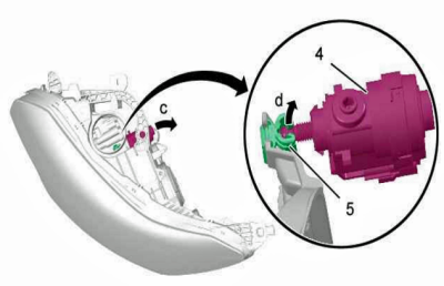

- x 6962
Re: C5X7 Can't code VIN in RD45
The unit is just a small device like a joystick attached to the headlamp that does the levelling:

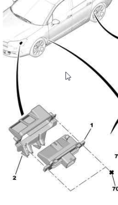

I thougt it was this module?
I tried to locate in on the car, since it shows as "No communication with unit"
C
C
- x 6962
No, that's only fitted on models with Xenon Directional Headlamps, which you don't have.

- x 6962
The dynamic beam corrector isn't shown as a part from your VIN, and from what I can see, the headlamp manual adjustment system consists of the 2 adjustment motors (one in each headlamp) and the manual adjustment switch on the dash.
Although I know there are some inconsistencies over these systems, so with hydraulic suspension, it may use the body height corrector data to adjust them if you don't have the manual adjustment switch on the dash - which may be for the metallic sprung versions without directional lighting.
As long as they work though... Just put the headlamps on against a wall at night and sit in the boot see if the beams move up or down according to the weight, (though you may need some friends or family members to assist
