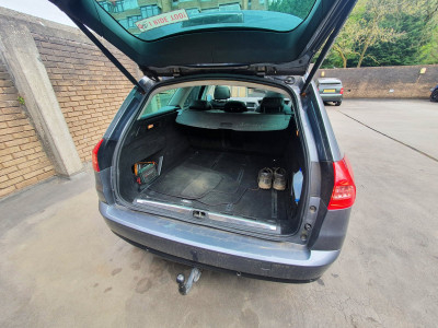

Cheers, it's not acting like it's failed only that it thinks there's something there. I actually had a thought: there's a tow hook and I wonder if that is upsetting it... might remove it and see if it changes

That will do it every time. You are supposed to deactivate the reversing sensors when towing of course, but if you have one of those non-retractable tow balls, that's your issue and the system is doing its job as intended.

It will be detected as an obstacle - the sensors are ultrasonic, and anything within 30 cm of the sensors make it impossible to detect, so if the obstacle is already there then this will cause the alarm as the towbar is within minimum detection range.

Is the bar and ball detachable? It looks like there's a twist lock on the side of the bar.

I think so, I'll be honest I've not played the tow bar much attention.. I don't tow anything and it was on the car already. I'll have a look later as I'll be doing some work on the car today for the first time in a long time...Paul-R wrote: 29 Jul 2022, 22:03 Yup, that'll be the problem.

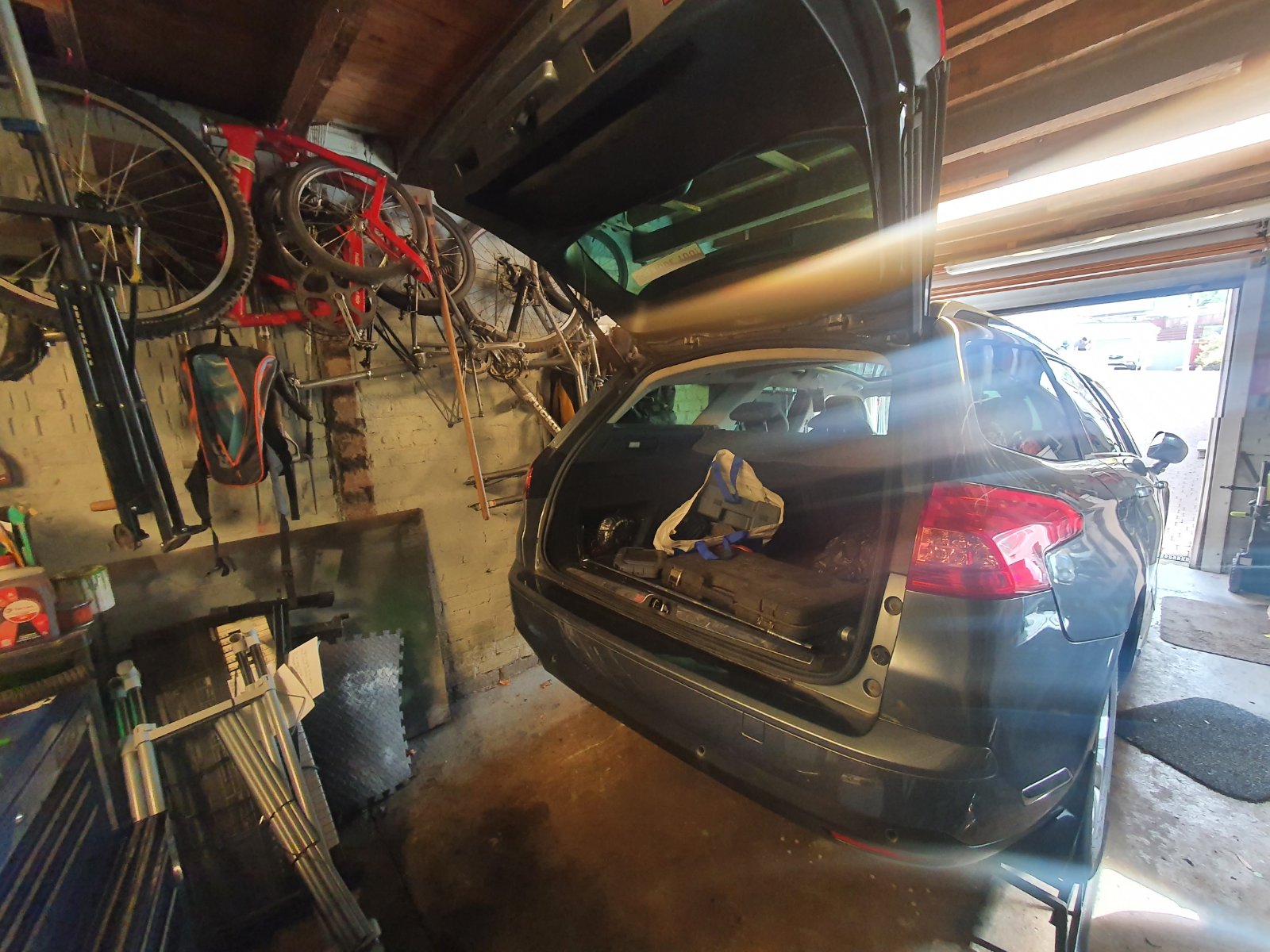

Ok! The tow hitch doesn't actually remove, it stows away up under the bumper, as does the plug for the electrics. Quite a neat mechanism although completely rusted. It took 2 hours to fold it away but it's away now! And it seems that this has cured the parking sensor anomaly!

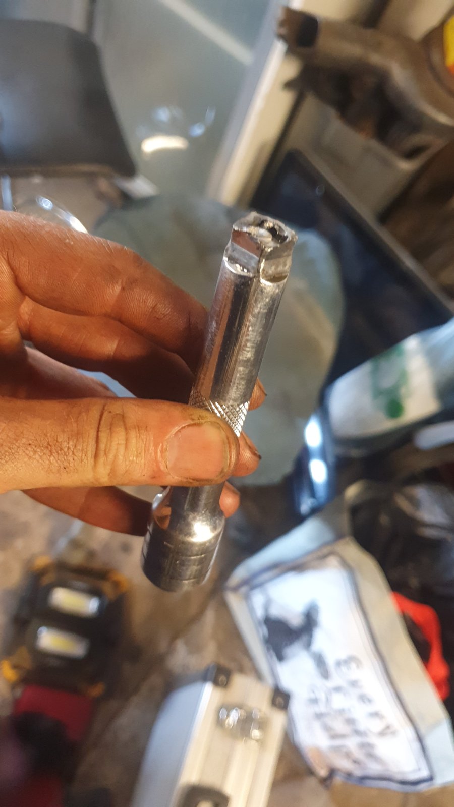

.. my attempt at removing the rear corner spheres however, failed. Like every other sphere on this car they are so tight that you'd feel the subframe will snap instead of the breaker bar. In fact the 1/2" drive extension the breaker snapped..
