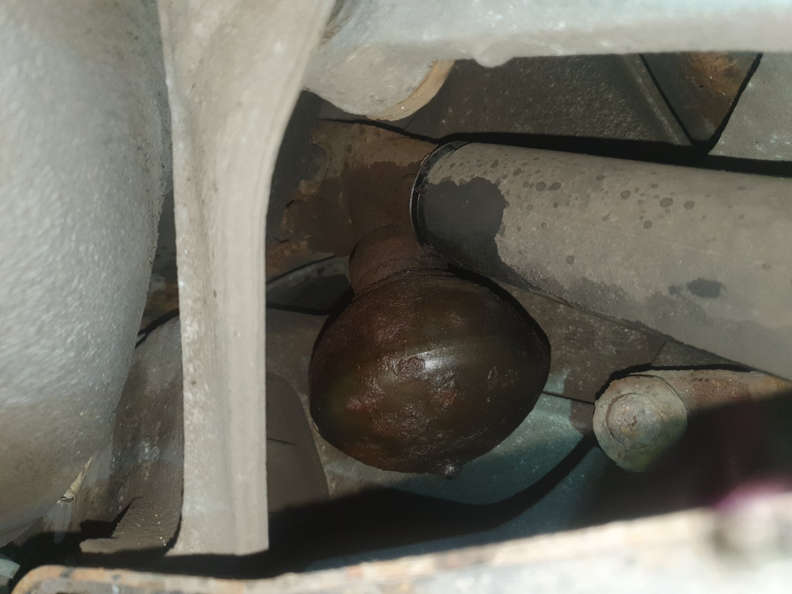

.. my attempt at removing the rear corner spheres however, failed. Like every other sphere on this car they are so tight that you'd feel the subframe will snap instead of the breaker bar. In fact the 1/2" drive extension the breaker snapped..

Good news about the towbar.
Not so good news about the spheres though!
