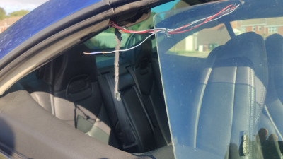

In most cases you will have a problem with roof switches b on the diagram. Problem lays with the loom. Over the time cable will snap. Before u will order a new switch check the loom. You have to put roof into intermediate position. Take out headliner. Then on the driver side of the roof you will see loom going from front locking mechanism and joining dome light loom. Dig it out. Take out black insulation tape and u will see probably this))
Re: 308 CC Roof lock switch location
Sometimes swotches are faulty... But check loom first
