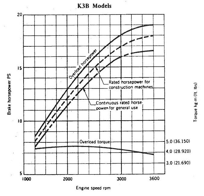

I'll try and post the horsepower chart for the K3B.
I guess a Kubota D722, D782, D902, D905 would fit best if I can find one?
