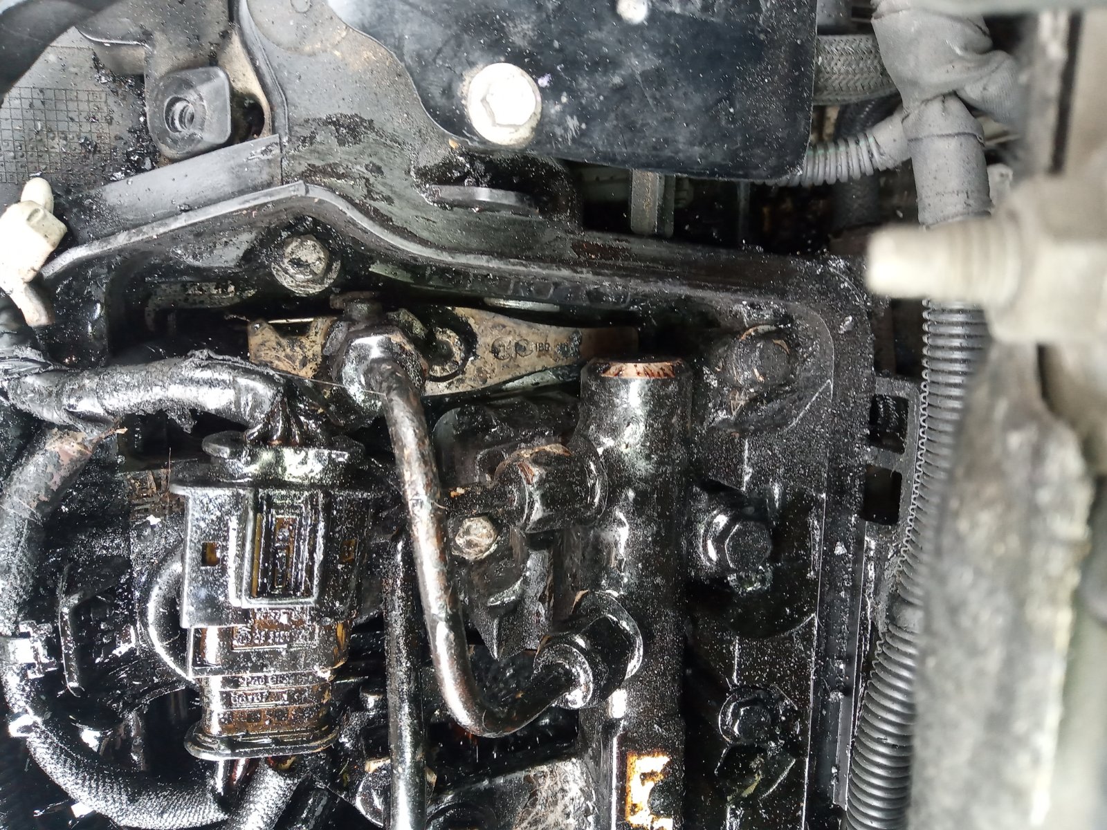

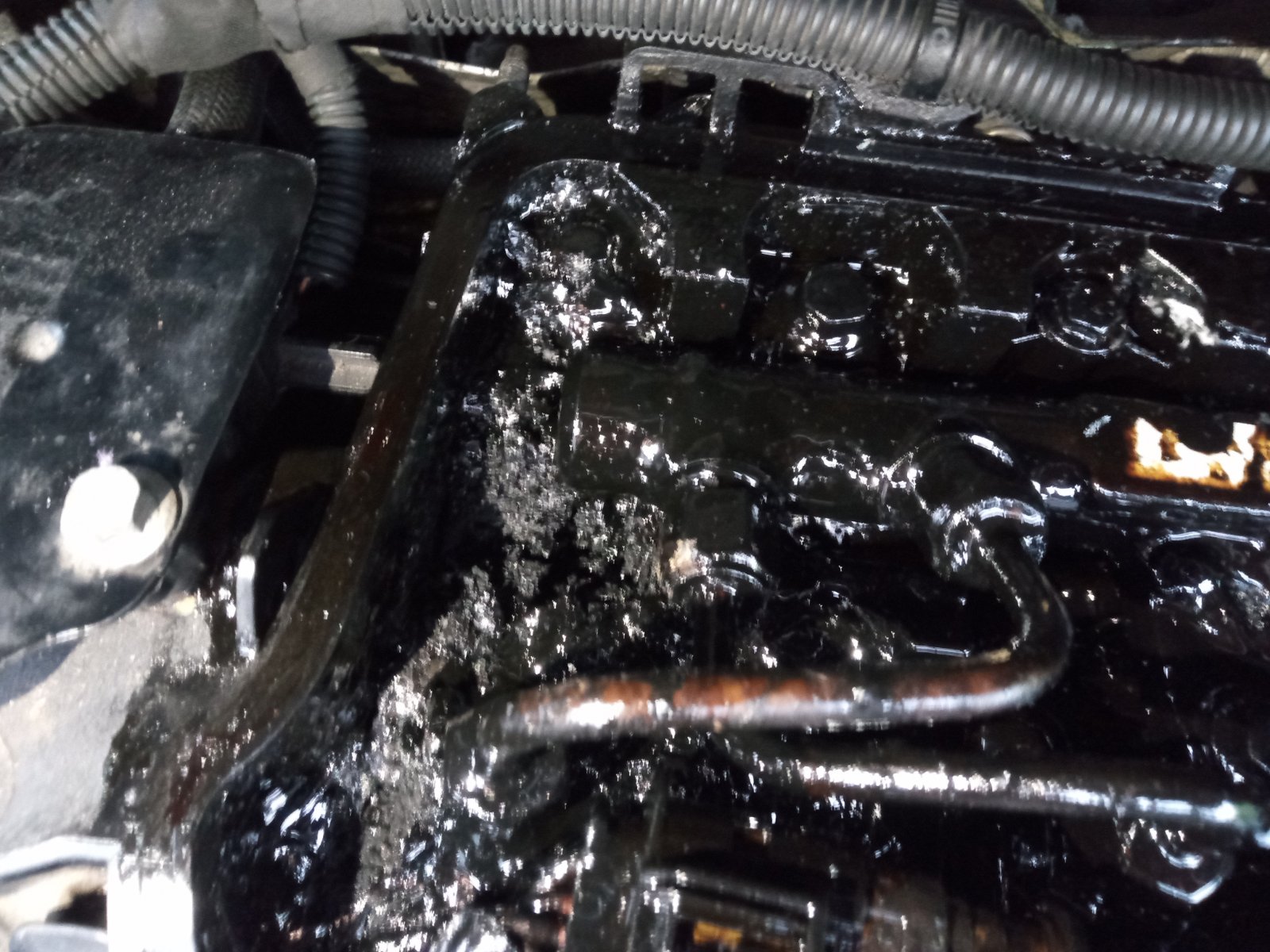

Hi all,
I have had an interesting investigation outcome on this. There was no engine light or service light on. I hooked it up to a "decent" code reader and hey presto, P0272 - cylinder 4 contribution imbalance ". Removed top engine cover to inspect injector and loom and was greeted by a sea of hardened carbon deposits. Almost unable to see cylinder 4 injector.
Seems the injector seal is leaking letting compression with unburnt carbon passed it. An hour later of cleaning you can see the injector. With it running, very roughly may I add you can feel the cylinder compression with your hand at the side of the injector.
So, next step is to keep cleaning, remove and replace injector and all the burnt loom and connections along the way as well as whatever else decides to crumble in my hand. It must of gotten hot under there.
Will keep you posted.
Rob
