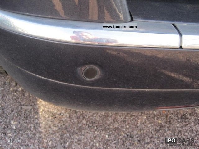

Hi all, im new here. Ive just bought a 2014 grand c4 picasso but none of the sensors are working & a friend put diagbox on it & said it was my distance sensor but where would i find this so i can replace it please.

They are those little round things in your bumper, see picture. I the faulty one will not Vibrate when VERY lightly placing your finger on it when it is activated.

None of mine are working, as soon as i push the button for ignition it bleeps & comes up distance sensor fault
