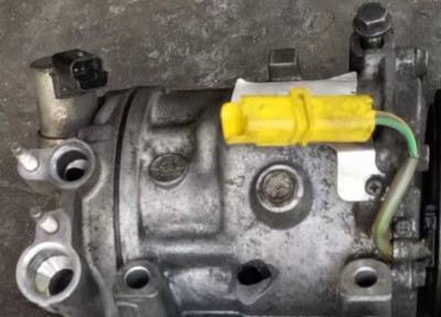

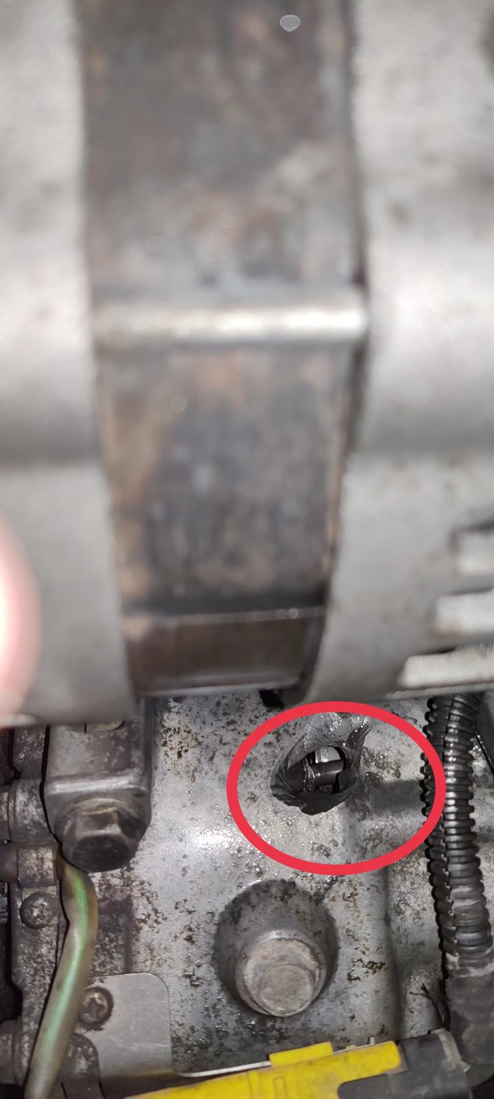

My 407SW 2.2 Petrol's Sanden AC Pump recently did this. Please see photos. :-D So I had to replace the pump and condenser and clean out the entire system...
