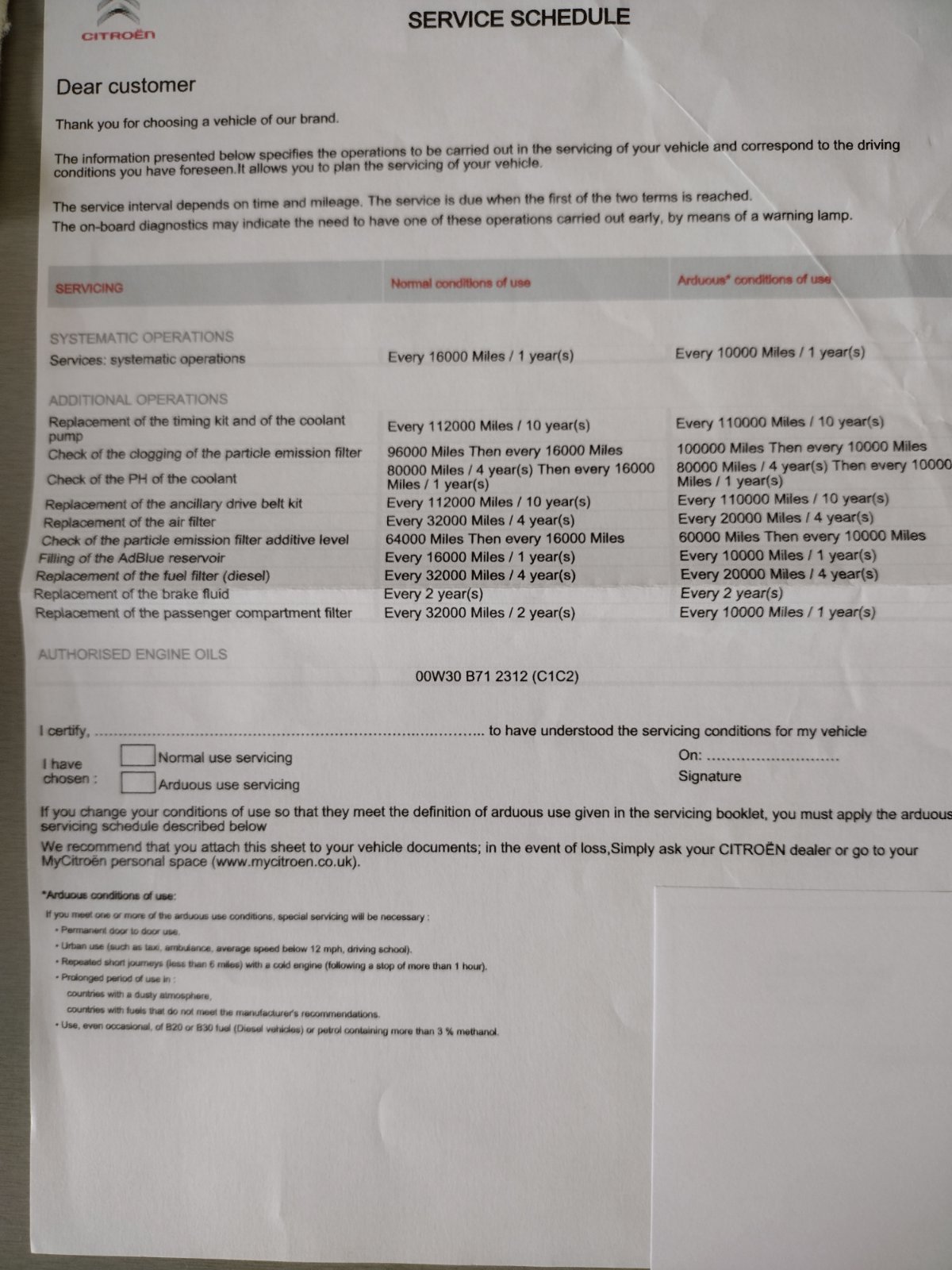

The service book for ours doesn't give the schedule, I had to login to / sign up to Citroen and download the schedule:
Reason: Image rotated

Er..see my post above? If you click on it it will enlarge and only be sideways :lol: cam belt is due at 112k
