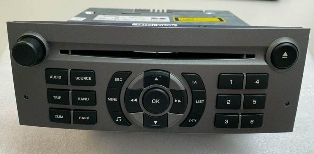

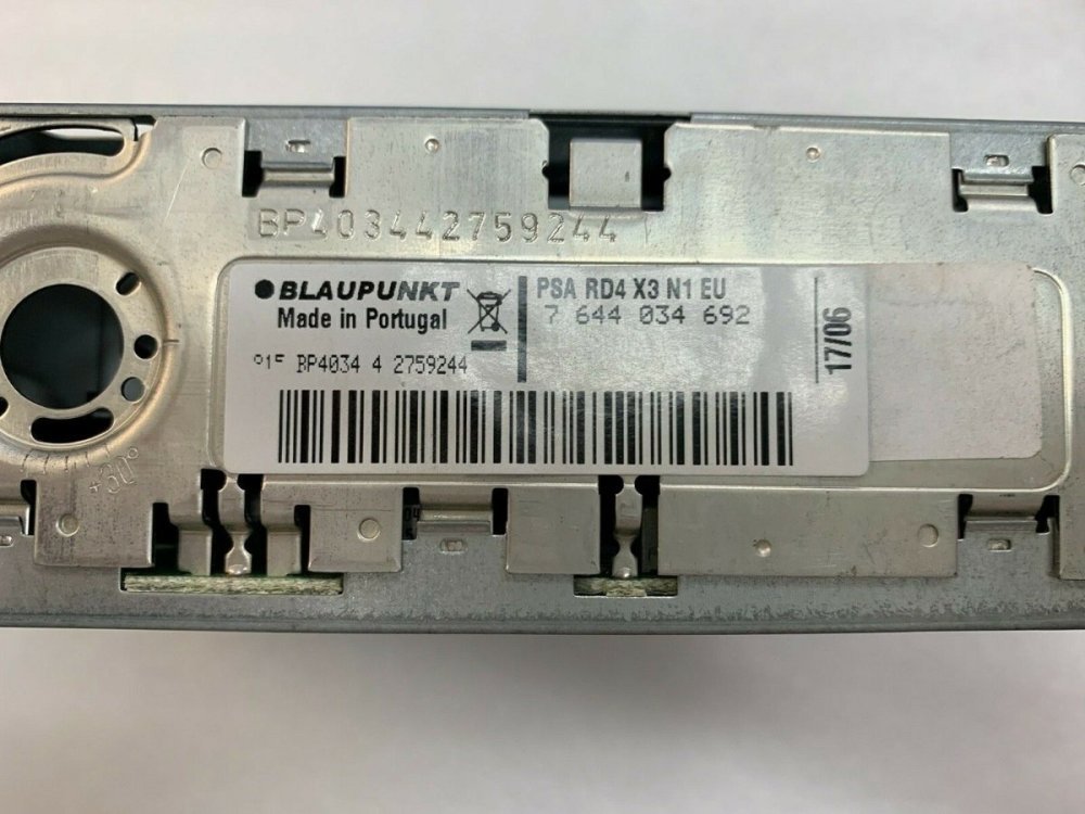

I have an issue with my radio/head unit in my c5 from 2005, the head unit is the Blaupunkt PSA RD4 X3 N1.
The issue is that it no longer responds to the numbers (radio station saved presets), or to most of the buttons, but curiously it does respond to the button "band"
which is on top of the button labeled "dark", but when i press "band" it does as if i had pressed "dark".
It's the only button that works, this band one, and it darkens the screen and i can cycle it through the 3 states, normal, dark, off.
Also another thing, the screen randomly changes this state, by itself, from normal to darker to off, back to normal etc.
