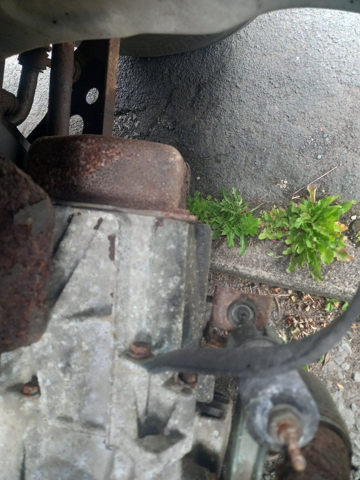

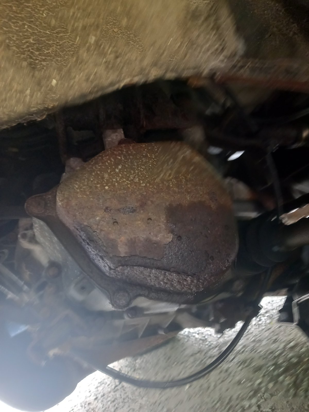

Hi I have a y reg boxer, 2001 1.9td . Looking for a part for my gear box but not having much luck. Looking for the gear box cover(rear cover/casing)but can't find one anywhere. Mine is very rusted and flaky and appears to be leaking(maybe) defo have a leak fyom somewhere i suspect gear box as bottom is oily but so is above further up.Any suggestions on where to look for the part or source of leak? Also Was this box used on others vans that I could modify my search results for? What gear box is it on my van?

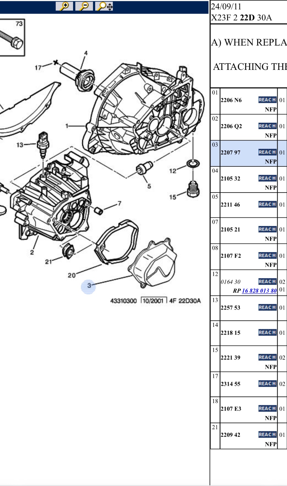

Would really need your VIN or reg to check what gearbox is fitted to your van.

OK you have an ML5T gearbox
There is one on ebay just now
https://www.ebay.co.uk/itm/224799133524 ... media=COPY
Failing that your best bet may be someone that does gearbox repairs, they may have some scrap boxes.

Cheers, looks different from mine(mine is flat on the end) but will speak to my mechanic
wheeler
Posts: 7892
Joined: 21 Sep 2002, 19:07
x 1044
Re: Peugeot boxer gearbox end case
Unread post by wheeler »
Thats the part number based on your VIN, i suppose the part could be labelled up wrongly but it certainly looks like the parts diagram picture.

Yes thats the VIN i used from your reg. Thats certainly the part it lists for your van however its not unknown for servicebox to be wrong on the ofd occasion. Is your van a 5 or 6 speed gearbox?
Its listed as a 5 speed but the flat end casings are often found in 6 speed boxes.
Do you have a picture of your gearbox?

Going by your picture i’d say that looks like the right part to me?
Maybe get the seller to measure it but is the correct part number listed for your van.

I've ordered it as its the best lead iv had, been on many a French and Polish site looking for the part.
Thank you do much gor your help your a star, propane gone out your way to help me, cheers much appreciated.
