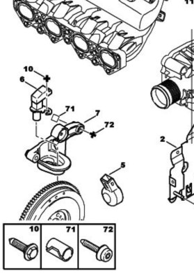

I have a Citroen Xsara Picasso Desire 1.6 petrol 55plate which misfires and has a fault code P1336 (crankshaft sensor)
I can’t find the sensor on my vehicle and there seems to be a few different models online but can’t find my exact one.
Does anyone know the exact location of the sensor and what it looks like (it’s not by the crankshaft pulley)
Any info on this specific model would be appreciated

The crank sensor is on the flywheel end on this engine. Its underneath the thermostat housing so can be difficult to see.
Number 6 in the picture.

Thanks wheeler you was spot on. Found it straight away and got it out. Will let you know if it works when I fit the new one
