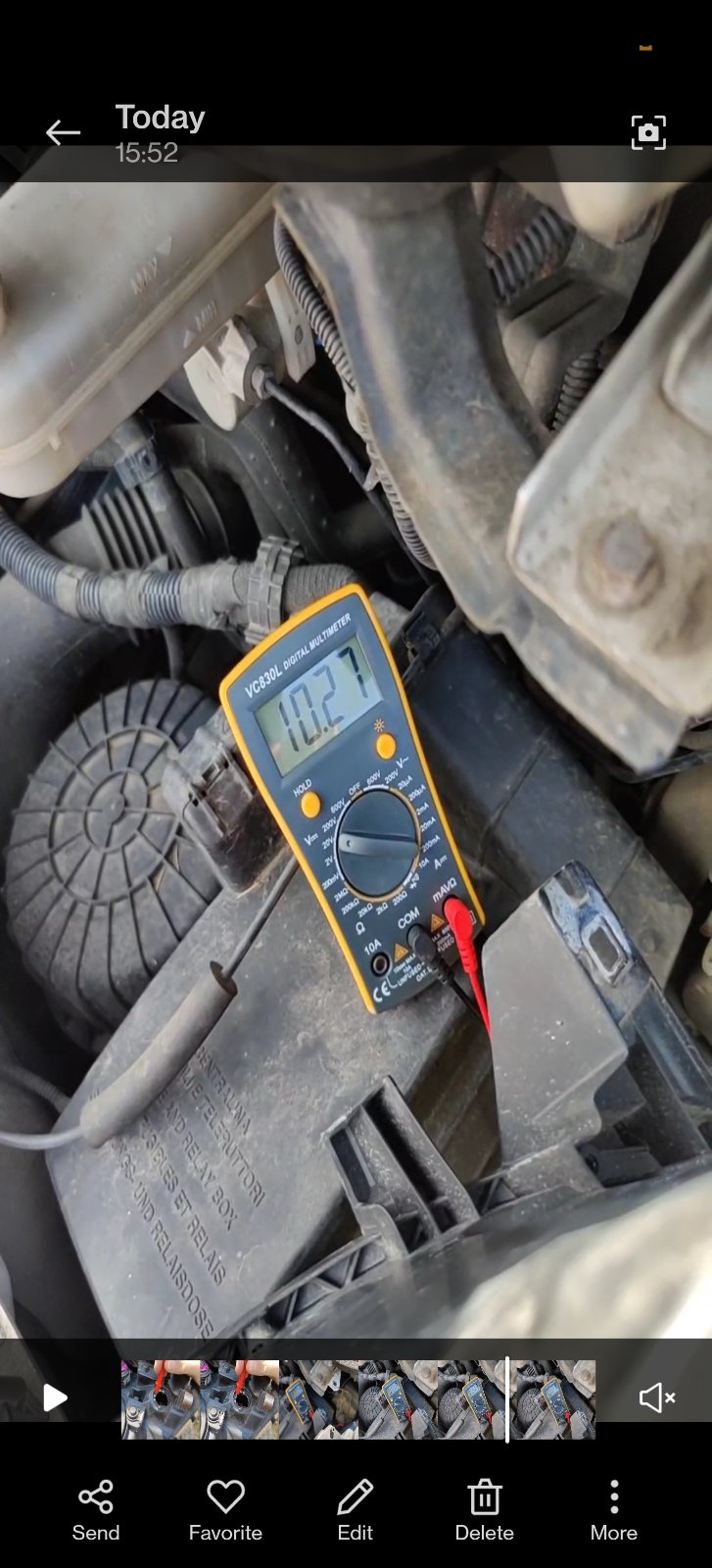

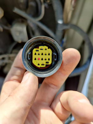

I'm new here, and was hoping I could get some help :-D I'm currently converting my Jumper '10 but I'm running into an issue. My indicator is not working properly, front left. I've checken the grounding, the bulb itself, a new bulb and if there is a current from the connectors towards the socket and there. It seems there is something not right in between the bulb and the socket but I can't figure out what.
I've attached a picture of the bulb socket.
Thank you already!
- Blaaskaakje

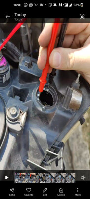

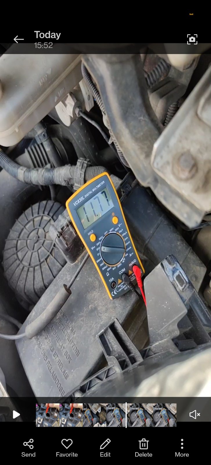

Thank you for your reply! Unfortunately, the video does not have the answer. I've switched the bulb, and even a new headlight unit (current one was bad anyways), and still no luck. If I check the connectors of the bulb, it does have power like the photo suggest, but it just won't light up.
I've tried a test lamp, and it worked for a second, but then that also won't light no more.
Help 😔

Check the plug is not the wrong way round (180° wrong) yes they will go in the wrong way if forced. I had this on my Peugeot boxer when it went to garage for repair and they plugged the headlight the wrong way.
