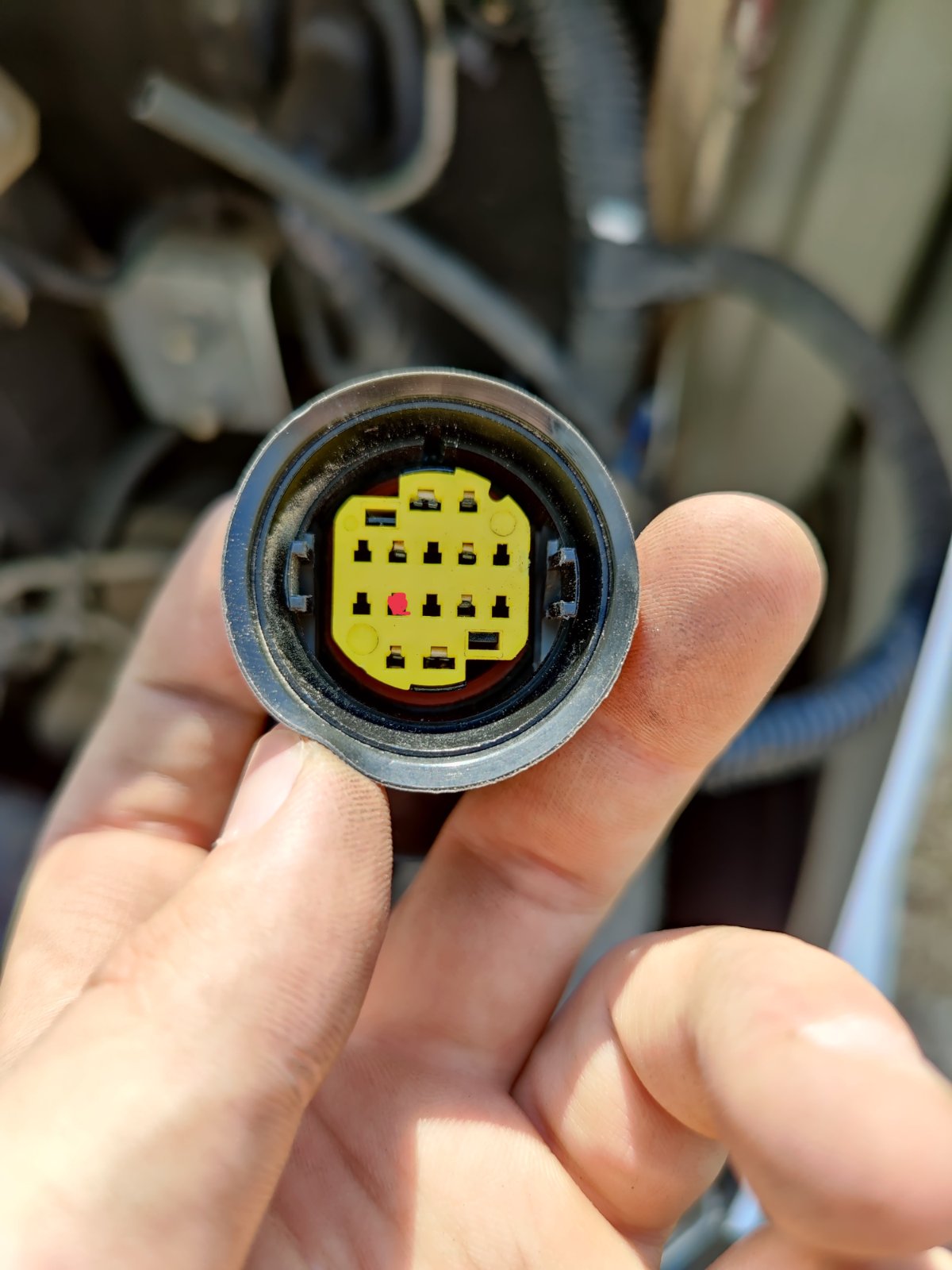

I'm new here, and was hoping I could get some help I'm currently converting my Jumper '10 but I'm running into an issue. My indicator is not working properly, front left. I've checken the grounding, the bulb itself, a new bulb and if there is a current from the connectors towards the socket and there. It seems there is something not right in between the bulb and the socket but I can't figure out what.
I've attached a picture of the bulb socket.
Thank you already!

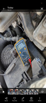

Thank you for your reply! Unfortunately, the video does not have the answer. I've switched the bulb, and even a new headlight unit (current one was bad anyways), and still no luck. If I check the connectors of the bulb, it does have power like the photo suggest, but it just won't light up.
I've tried a test lamp, and it worked for a second, but then that also won't light no more.

Check the plug is not the wrong way round (180° wrong) yes they will go in the wrong way if forced. I had this on my Peugeot boxer when it went to garage for repair and they plugged the headlight the wrong way.
