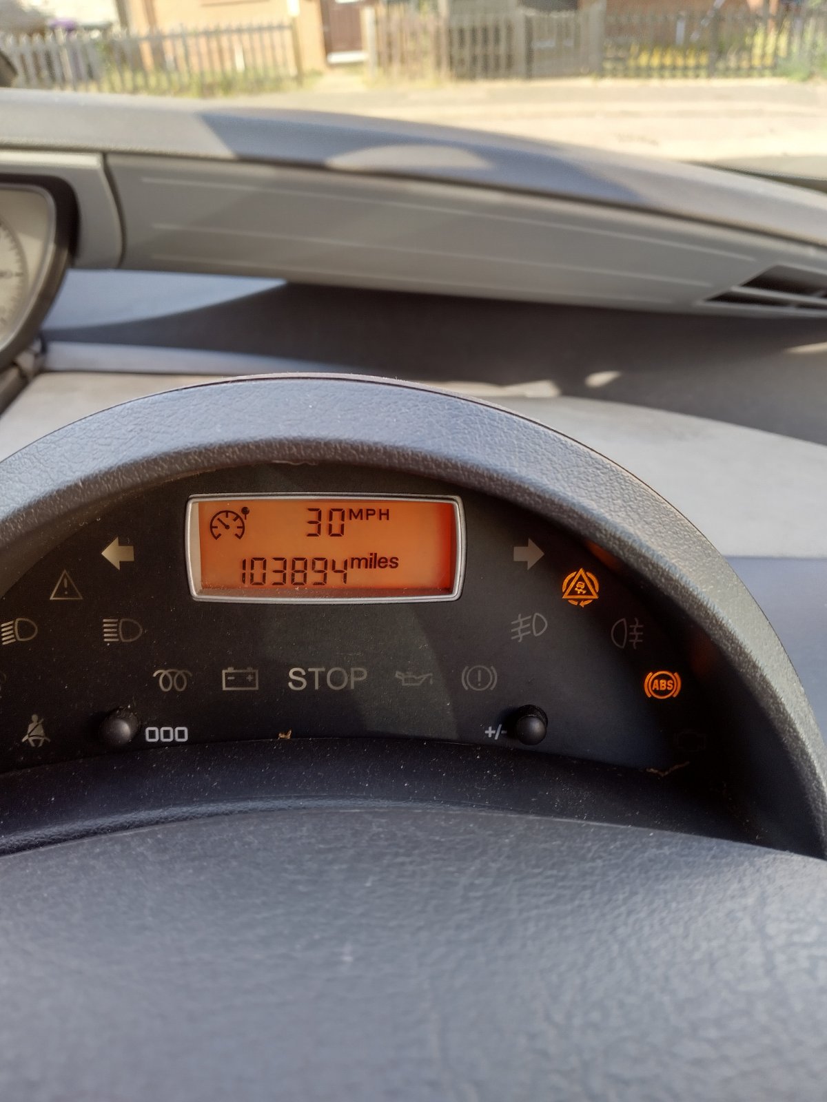

Since putting the dpf cleaner in it stopped all dpf due to be blocked and coolant low warnings. The car has done 103000 but the engine only 80k (best guess)

Ok, so if on the original DPF you are on the outer limit. It doesn't matter about the engine, but how much DPF additive has gone through the system.
The Eolys fluid contains an organic compound called Cerine. This, along with other engine-borne matter, cannot be burned off in the particulate filter through regeneration, so ultimately causes the filter honeycomb to block along with the ash.
So you may be due for a new DPF, or it will need taking off and deep cleaning. So if on the original it has done 16 years of service....
