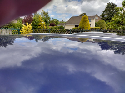

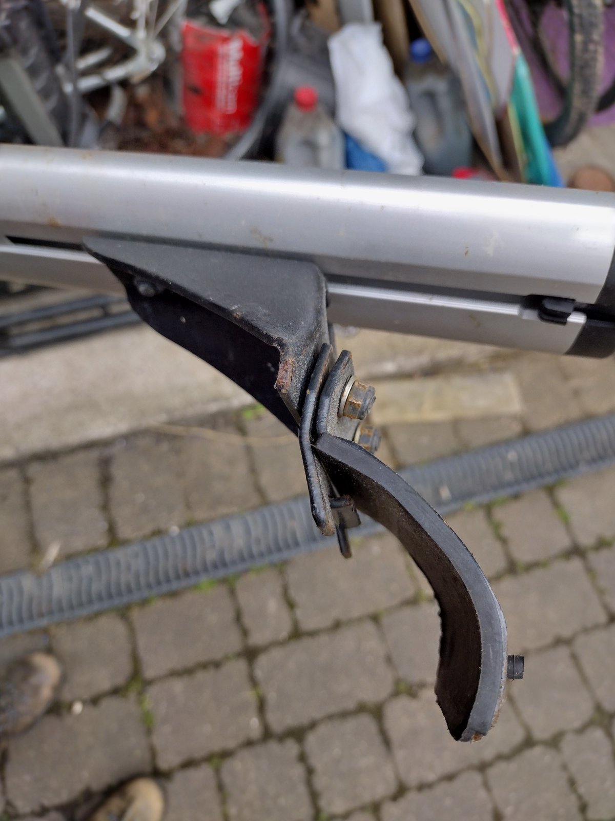

Here's our 2017 with the rails. Close up of the slot in the rail, and the end on the bars
Difference is explained here: https://www.roofbox.co.uk/scripts/rbveh ... query=8182
The bars I have got were not dear, sure I paid less than £100 for the bars, and 2 sets of ends - one for the C4 and the other for my 3008. Seem secure, I've used a roof box and had a canoe on there a few times.
