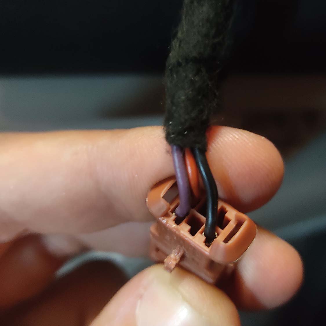

I have removed the buttons to see the connector and it only has 3 cables, I don't know if it is ok

Fixed image, sorry!GiveMeABreak wrote: 07 Jun 2022, 00:00 Unfortunately your image link is dead or private. No need to link to a third party image site - upload your image directly to the forum:

Tomorrow I'll check the wires that run to the door. Do you know if there is a memory module inside the door? I've read something similar but I don't know if it's on the driver's or passenger's door.

The seat position memory control pad fits onto the door trim finisher (with the memory buttons) and then goes to the driver's door control pad (that operates the electric windows and mirrors).
Pop your VIN up for me and I will put the diagram up for you.
