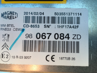

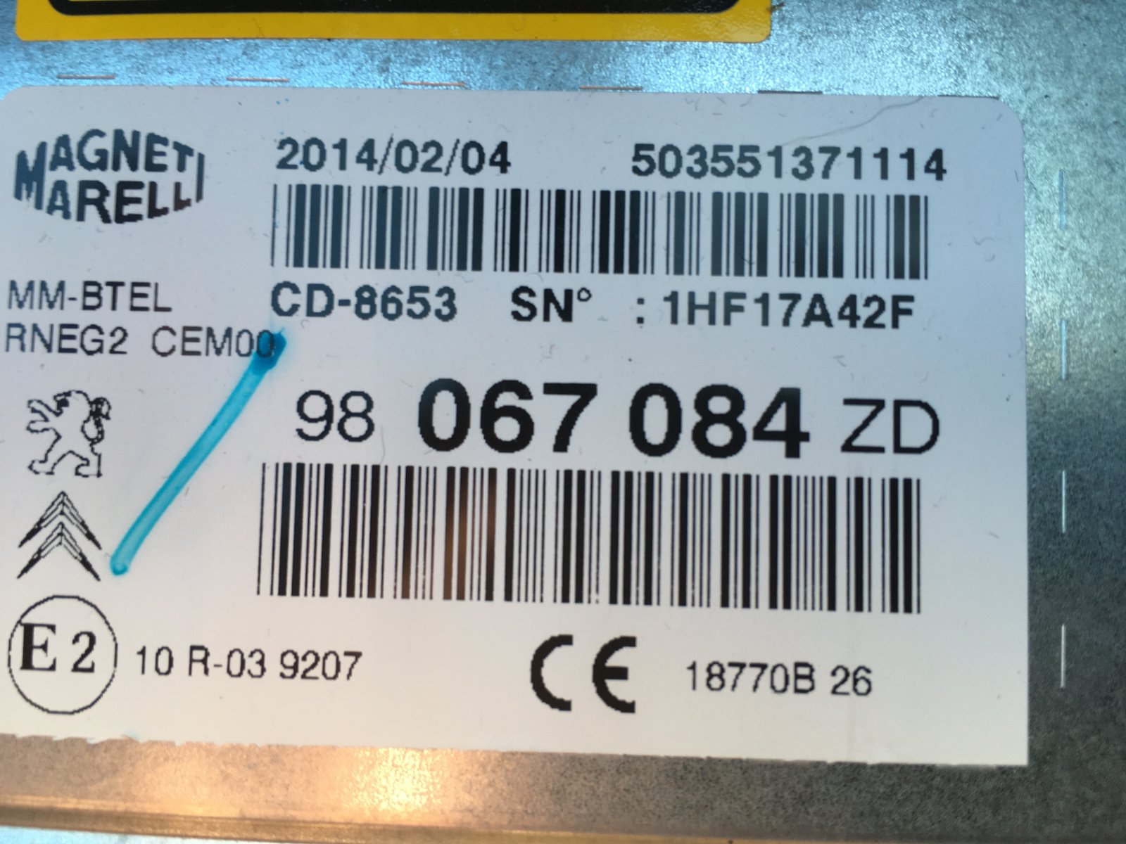

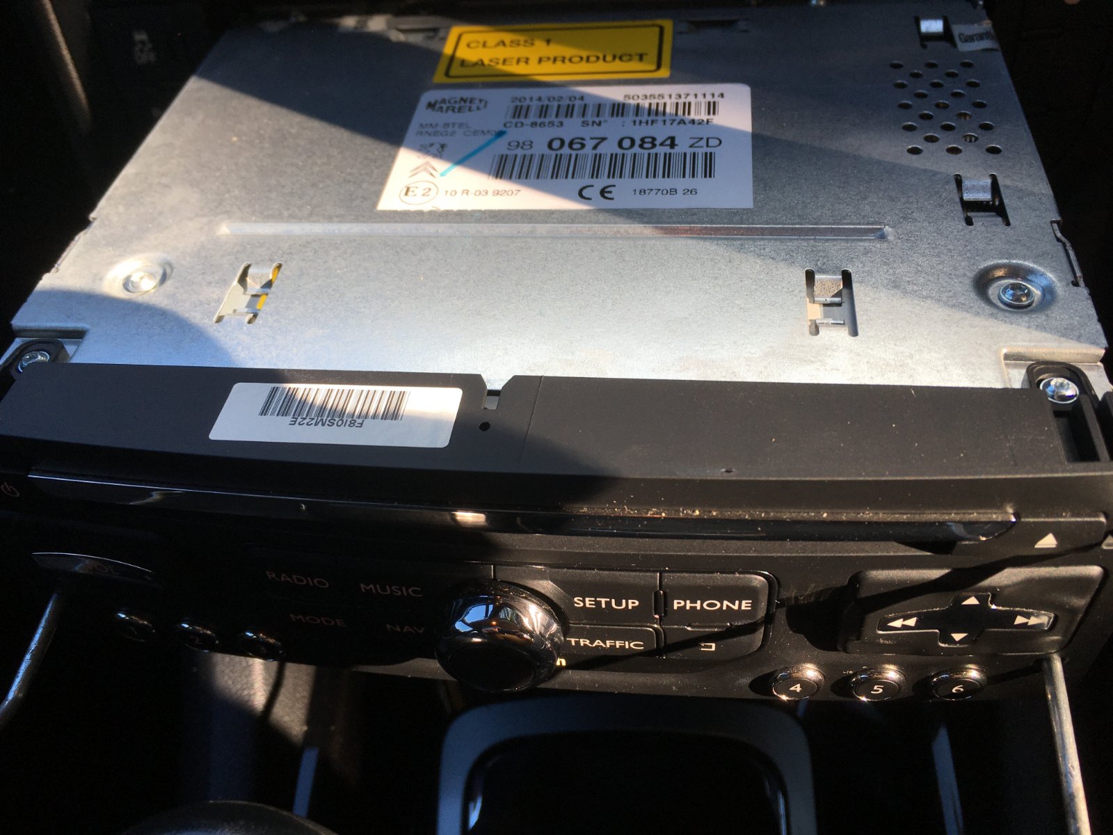

Hi, I would like to know if the Model Citroën C5X7 2014 sedan has an antenna booster already fitted ?? If not, what type of antenna connections does this radio have. Unfortunately, I did not take any pictures when I removed the radio. Does anyone else have problems with poor reception on this radio. If it does NOT have a signal booster I intend to install one. Any recommendations on a good booster would be helpful. I have attached a couple of photos from the installed radio.

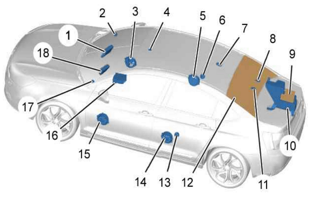

RT6 with Equaliser Amp, Saloon. So your aerial amplifier for FM2 is shown at (8) and for FM1 at (11). Note the actual FM2 aerial is screen-printed onto the rear window.
(1) Audio amplifier (*).
(2) Front right tweeter.
(3) Front RH woofer speaker.
(4) Carphone microphone.
(5) Right hand rear speaker.
(6) Rear RH tweeter speaker (*).
(7) GPS aerial / FM1.
(8) Aerial amplifier FM2.
(9) CD player (*).
(10) Subwoofer speaker (*).
(11) Aerial amplifier FM1.
(12) Antenna FM2 screenprinted into the rear screen.
(13) Rear LH tweeter speaker (*).
(14) Rear left loudspeaker.
(15) Front LH woofer speaker.
(16) Radio-navigation RT6.
(17) Front LH tweeter speaker.
(18) Independent telematic unit.
(* according to equipment)

Re: C5X7 2014 Antenna Boosters- Poor reception-Radio
Ah right, I wondered why only one of mine has an aerial on the roof, is that for the satnav?
- Posts: 9317
- x 1938
Yes. See my post above. viewtopic.php?p=719387#p719387
