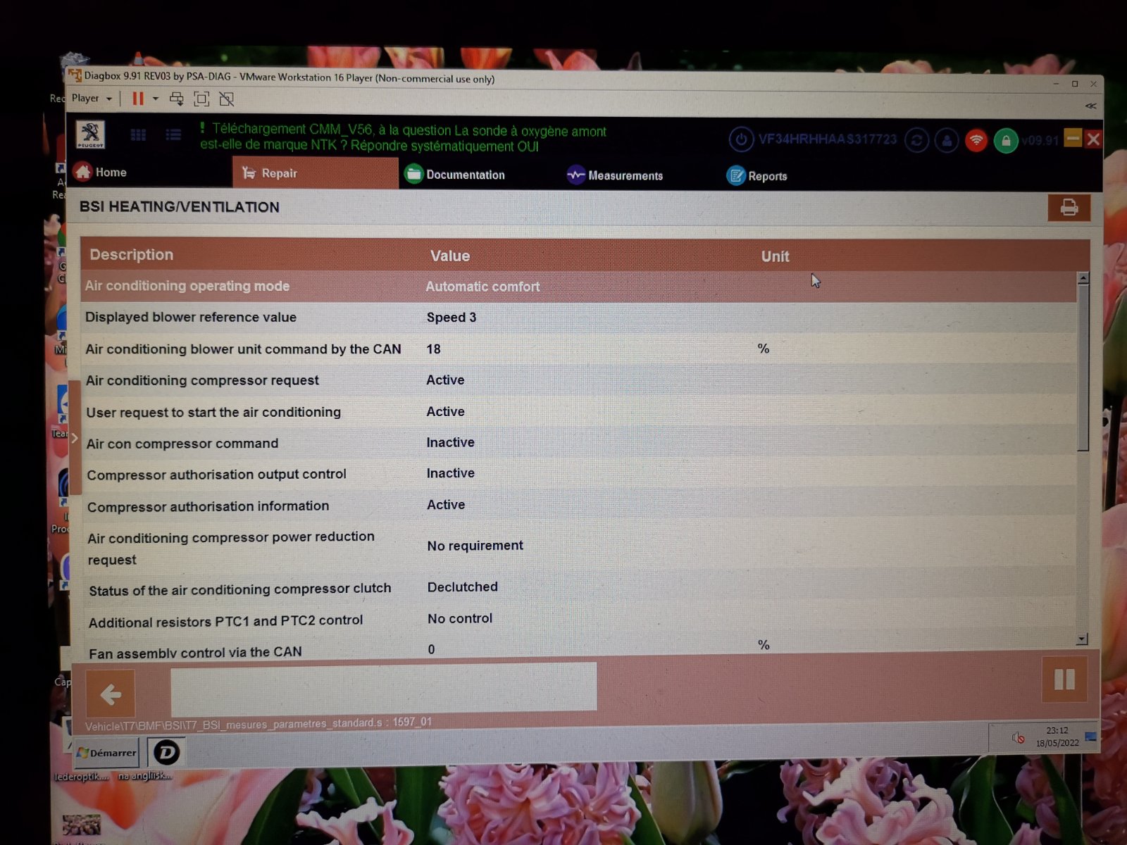

So I've got a 2010 Peugeot 308 T7 and the A/C stopped working. The compressor doesn't kick in. The system must be full of refrigerant because I had it serviced two weeks ago and there are no visible signs of leaks (the a/c oil has a UV dye in it but I couldn't identify any leaks).

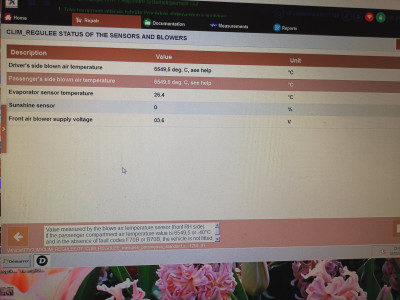

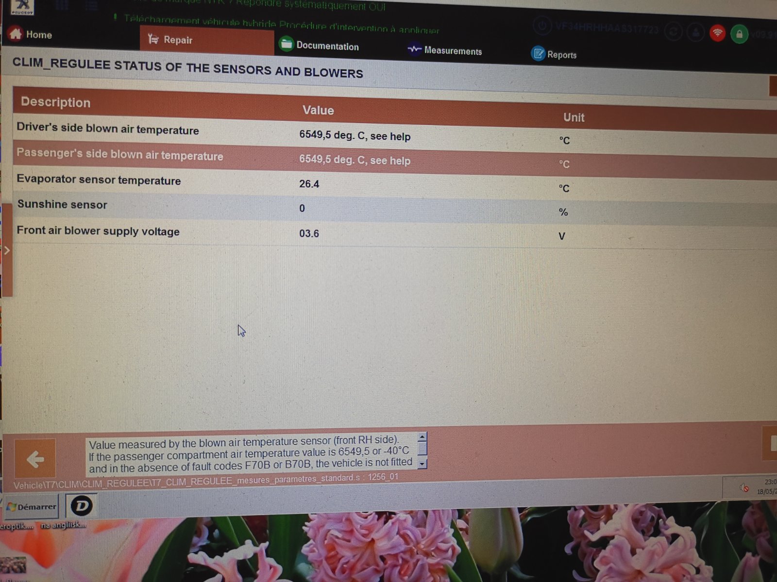

I noticed the following very peculiar live data:
The car has a two-zone AC control. So I find it very implausible that the sensors are dead on both sides. There are no further DTCs.
Could this be a reason for the compressor to not kick in?
Where are these sensors physically located?
Thanks in advance :)
PS.: I have also uploaded the live data from the BSI - would be grateful for any troubleshooting tips.

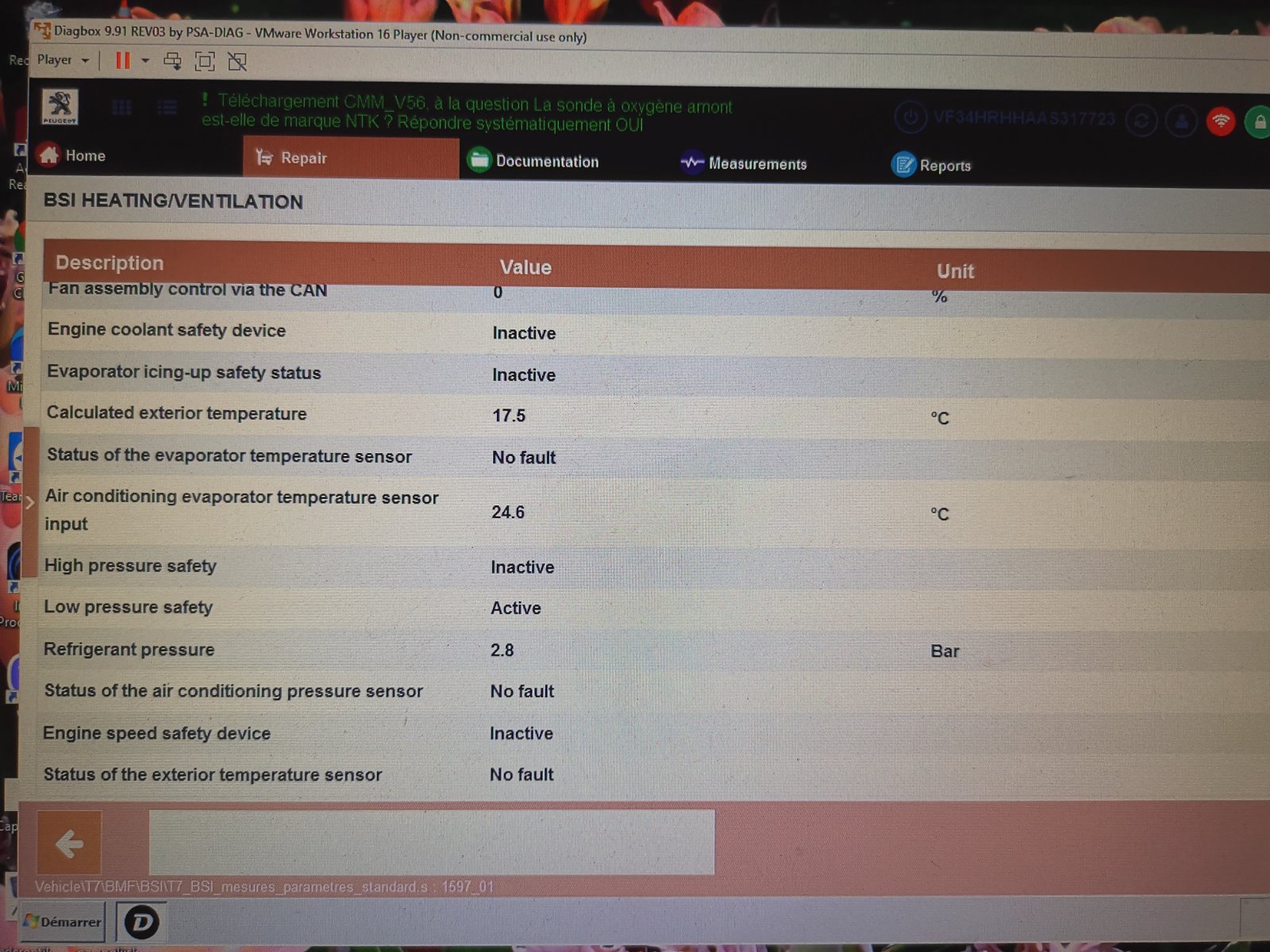

Looks like the low pressure switch is activated. Either there's not enough gas in it, it the switch is faulty.
icu12345
Posts: 24
Joined: 11 May 2021, 17:05
Re: Peugeot 308SW T7 - are these sensor values normal?
Unread post by icu12345 »
Thank you for the insight. I must've missed the "low pressure safety". However, as if missing the line in the live data wasn't embarrassing enough, I can't seem to locate a sensor on the low pressure line. There is one 3-wire-sensor on the thinner line but this must be the high pressure switch. So where should I look for the low pressure sensor and is there one at all? There is nothing on the condenser as well. The car is a 2010 Peugeot 308 2.0 HDI.
