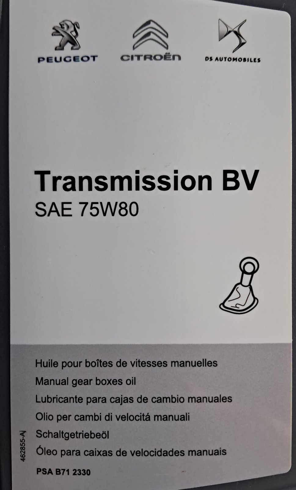

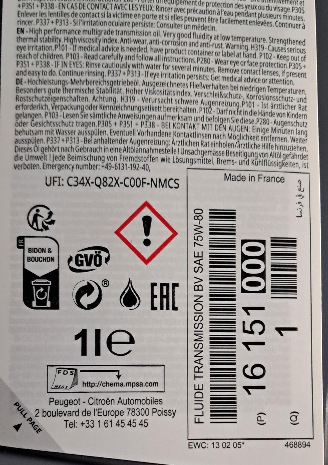

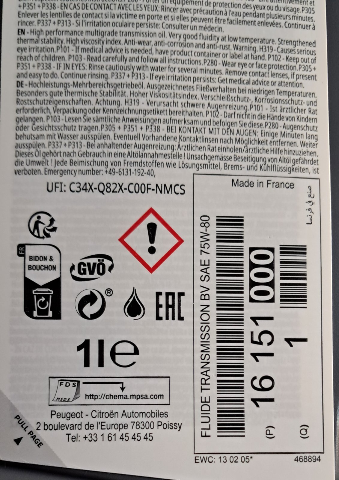

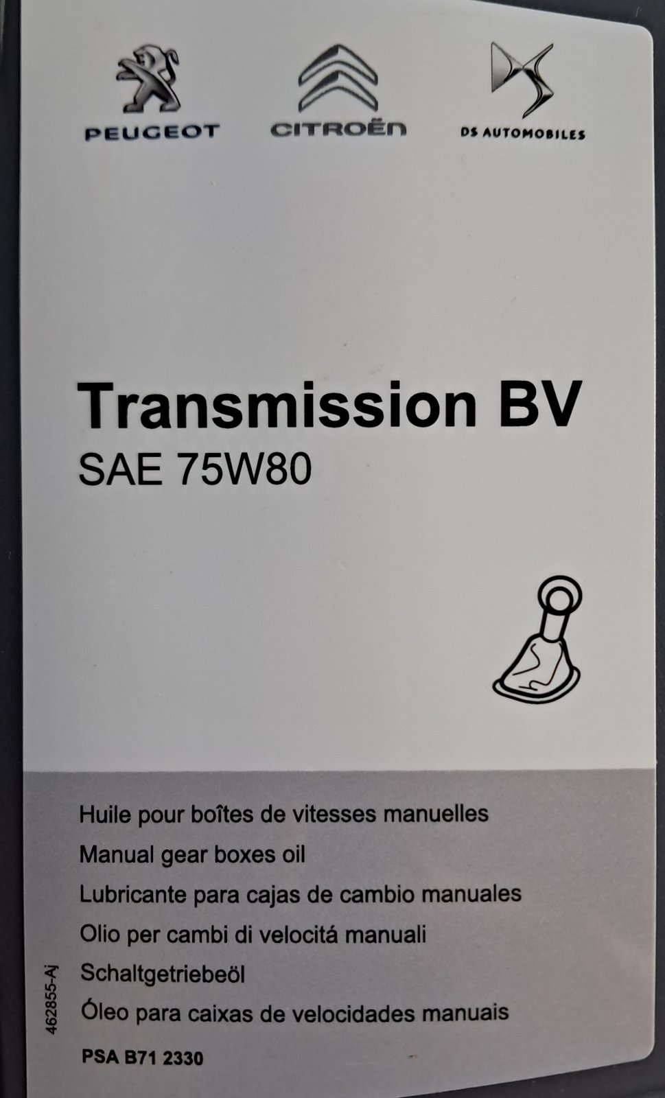

Hi again, sorry to be a bother. I just came back from the Citroen dealership and opened the box, this is what they gave me. There's nothing on the labels anywhere saying FE or API GL-4 (as I know I cannot use GL-5). It does say High performance multigrade transmission oil in the small print on the reverse. He told me that this is the oil they would use if they were doing the service. Now I am concerned if this IS the right stuff to use. Any advice would be appreciated.

Re: C4 B7 Semi-Automatic Gearbox Oil Specifications
Unread post by Paul-R »
If you pull at the corner where it says PULL PAGE you should find some more information underneath. Maybe what you want will be written there.
Apart from that the B71 2330 specification will be the final decider.
