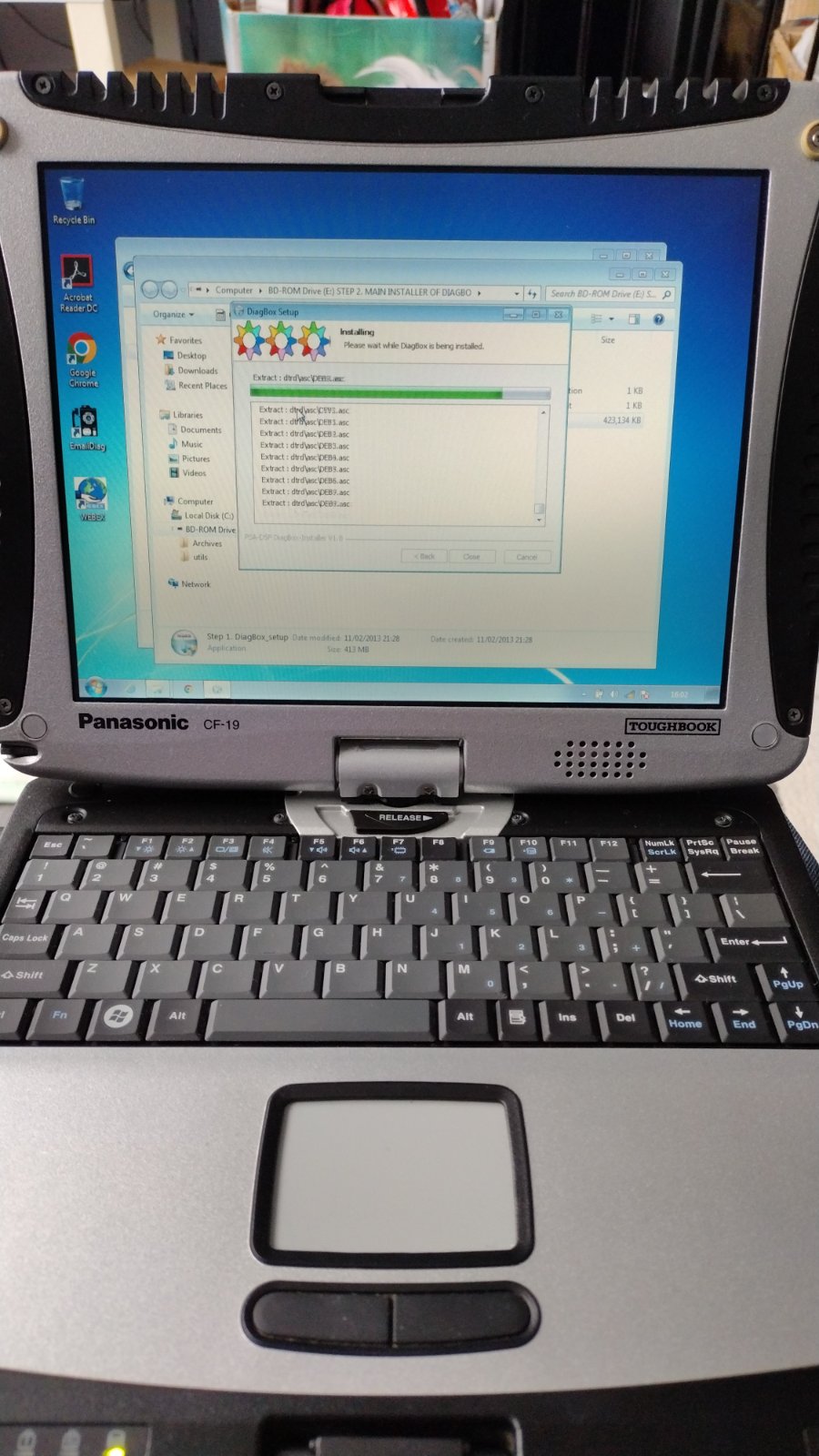

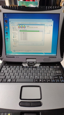

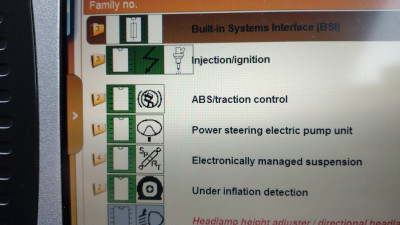

Well, hardware arrived and a nice rainy day today: just right for tackling the installation!
Not the simplest install, but excellent instructions and a video in the pack from Easy Diagnostics saw me muddle through without incident.

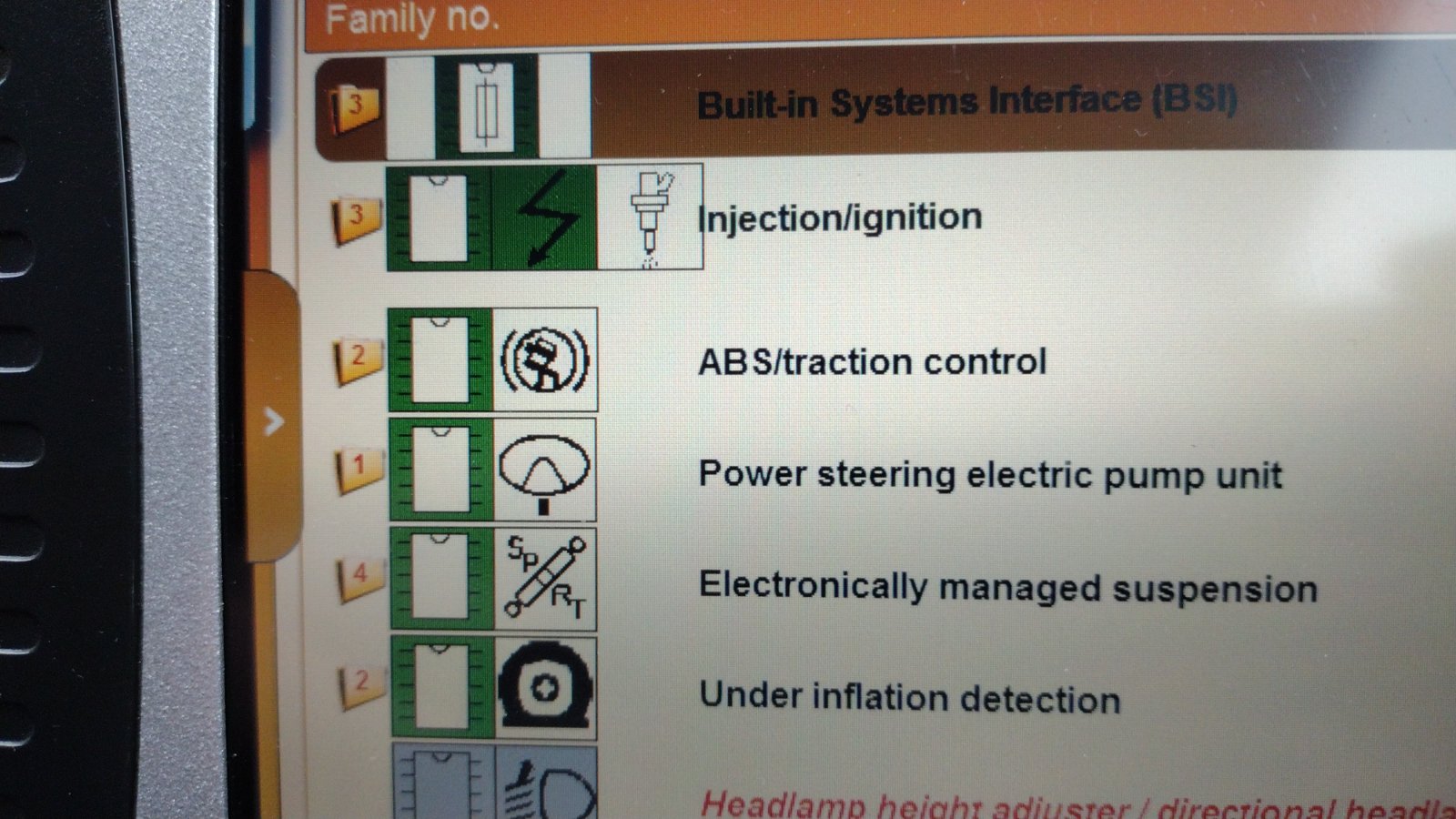

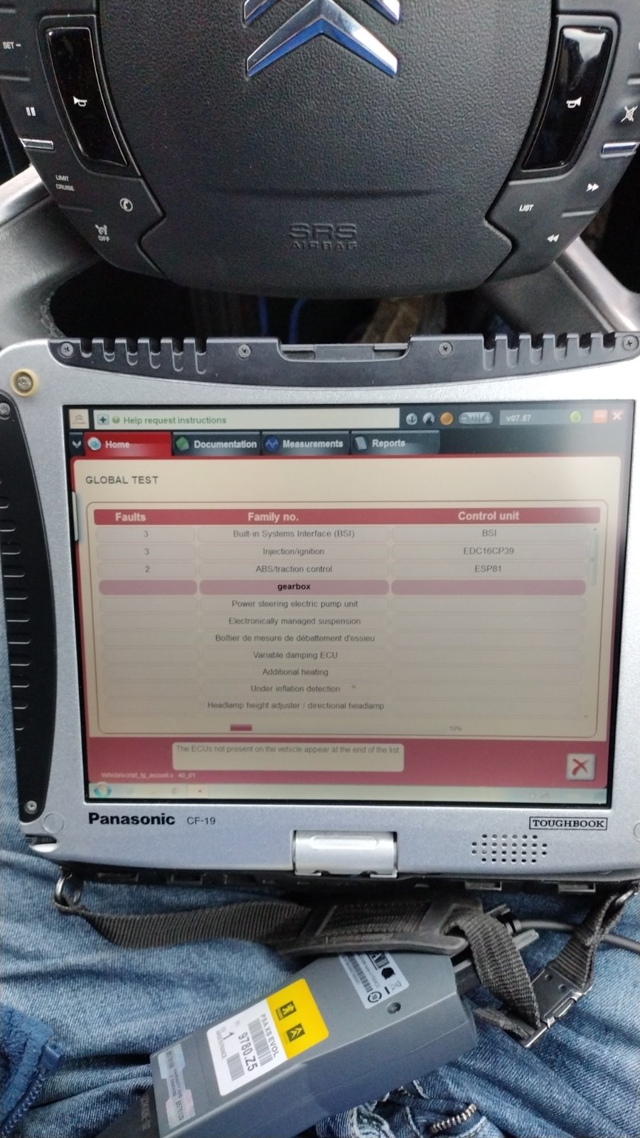

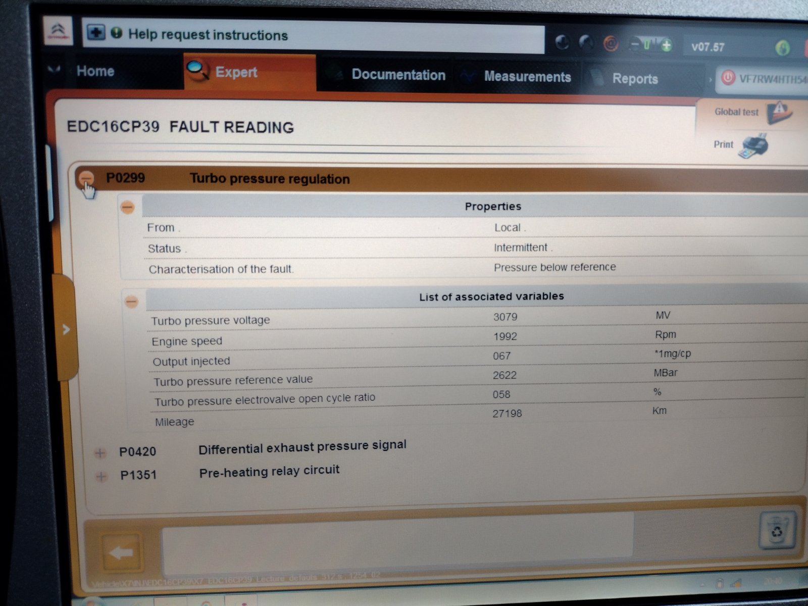

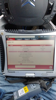

Have just had a very quick go plugged in to the C5 with a final break in the weather. Loads of faults logged, lots if BSI ones and "ancillary systems" (parking sensors - which I know don't work, plus many others tyre pressure monitoring, elec handbrake and others raising codes too. Hopefully all historic as both handbrake and tyre pressure monitoring were working fine as far as I know)
A few BSI and a few logged against "Injection/ignition" that I guess are the ones to focus on to get to the bottom of the current "won't run" situation.
Will get the codes up here, probably tomorrow. Need to find how to clear them (found something then it talked about some sort of permanent log on the ECU (with ten goes out of a maximum 50 already used) so decided to chicken out on that menu till I've read up a bit more.

Getting set up
Getting set up
Plugged in to the car
Faults
Faults
Matt
