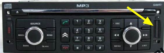

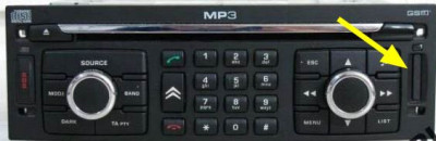

Ok, so the reason why is that you have an RT4 telematics system which does not have bluetooth....
Instead, the RT4 uses a SIM card that is directly inserted into the RT4 on the right side as shown in yellow:
