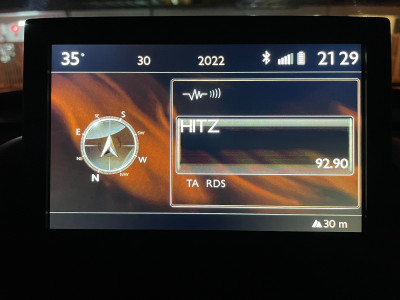

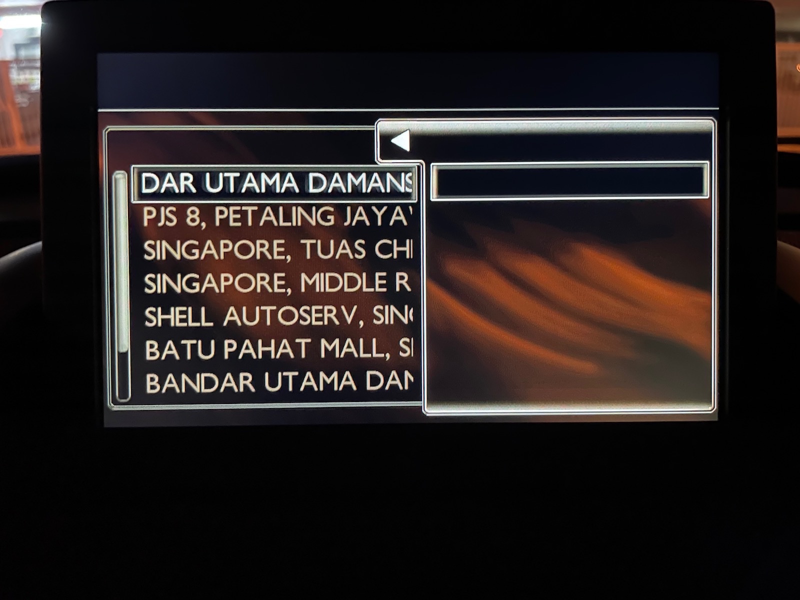

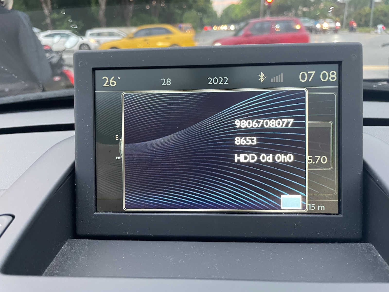

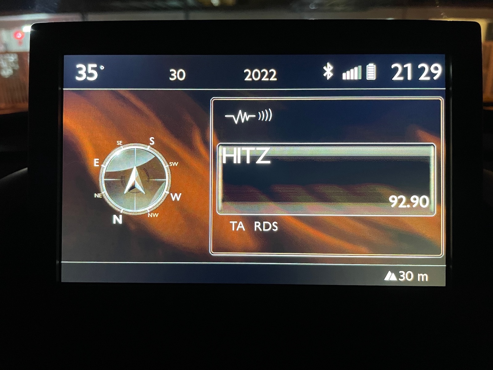

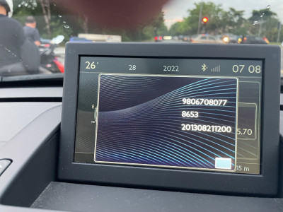

Hi all,
I just bought a used 2014 Peugeot 3008. Initially I didn't realise that the headunit was faulty because the radio, camera etc seems to be working fine.
I then realised this issue when I start to try the buttons on the headunit. Try to reset with eject button hold method didn't work.
Now, I would like to ask for a help from anybody here to maybe just restore it back to the factory settings, before I go for the SD card change method.
FYI, our Service Center here in Malaysia is useless and I'm not sure if I can get any update CD from them.
Attached are some photos showing what is happening to the RT6 and maybe in one of the screen have the version number (RNEG 2.75 D2)
My VIN number VF3**************[VIN obfuscated, can be read by forum staff]

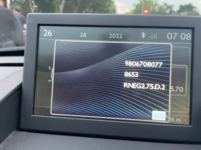

Re: Missing text on RT6

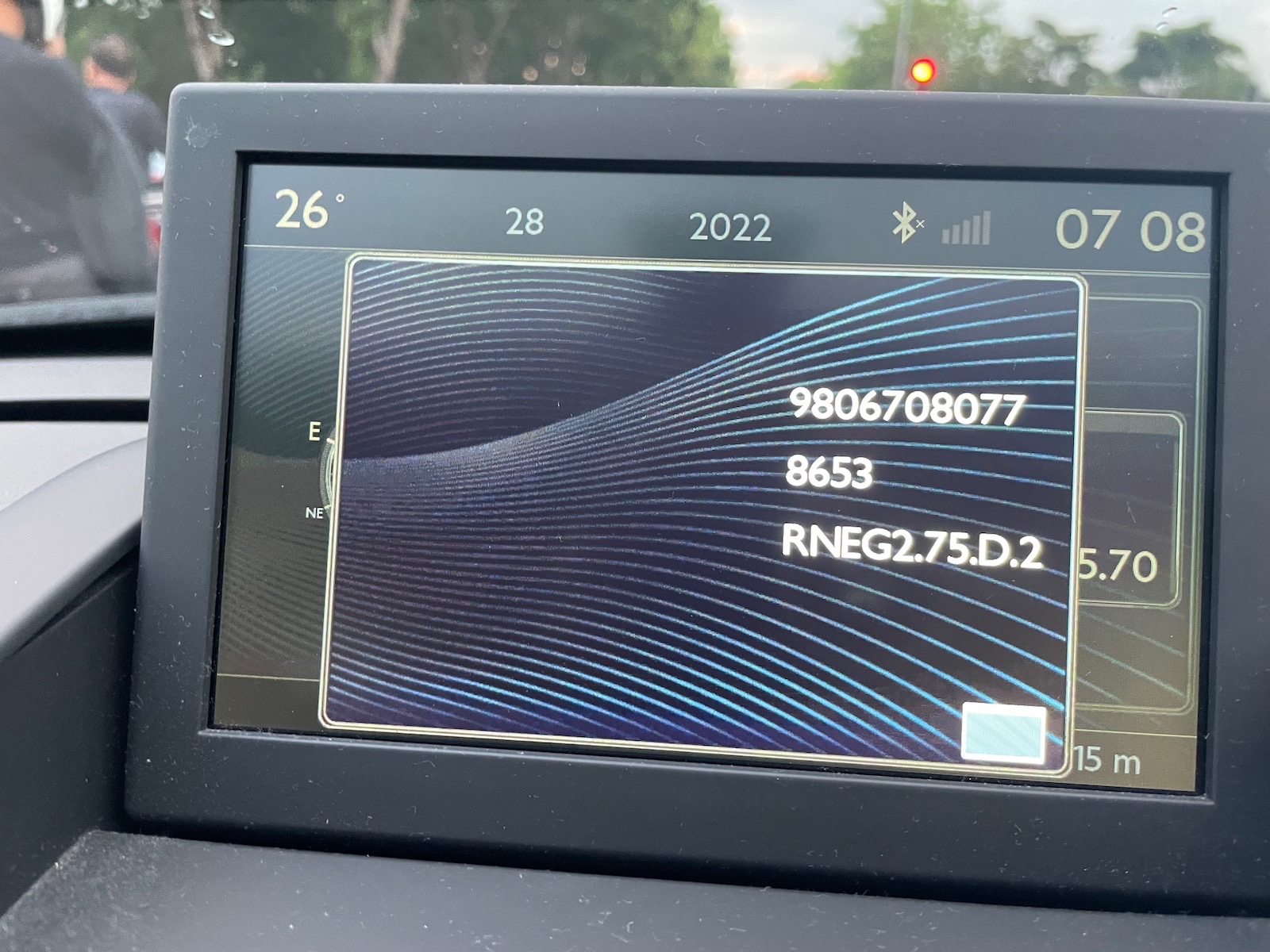

Your current RT6 unit has firmware Version 2.75.
There is no hard disc in these units, just an internal MicroSD flash memory card that acts as a HDD.
As long as you have functionality of the radio screens and other screens I would leave it alone - that's if the 'missing' text is only on the Setup screen shown above. Try changing the 'theme' to another one also.
My information would suggest that you can upgrade to Version 2.80 without going to the dealer, but of course with any firmware update there is always a risk.
You may want to try a full BSI reset first, but leave the battery off for 10-15 minutes or so instead of the time quoted in the procedure to see if that resolves the issue, then take it from there.

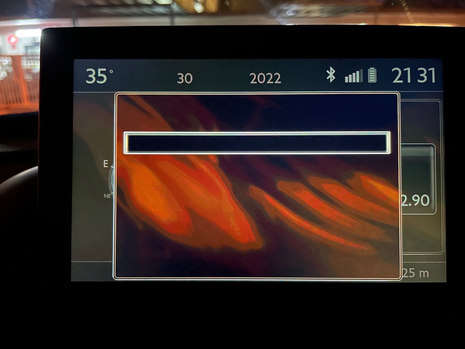

Thanks Marc for the reply.

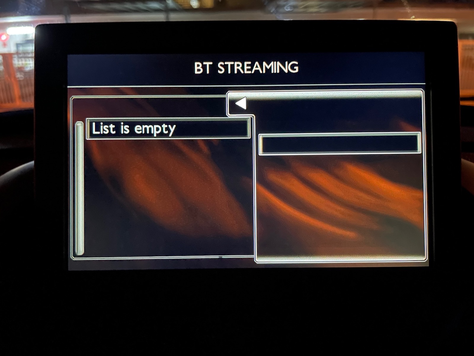

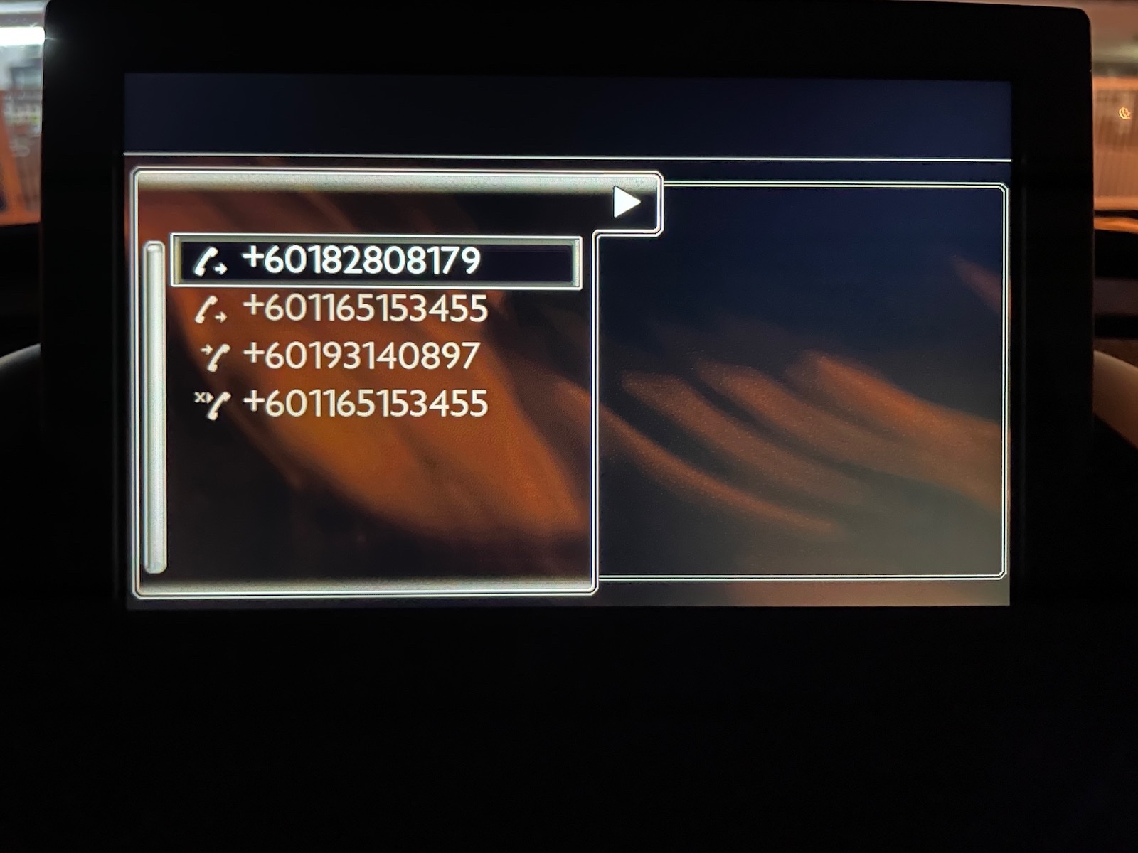

My issue is not just the text for the navigation. The whole font file (is there any?) is missing (that's how I look at it in computer terms). In the following attachments, you'll understand what actually happened.
I can't do any setup or configurations to the car lighting, parking assistance etc. without knowing which one is which. All of the menu in the Setup functions is empty. What I can do now is just blindly navigate based on the Menu Map from the User Manual.
Here's what I did to try to restore the system;
- Change Theme (blindly)
- Change Language (blindly)
- Use Mirascript to backup User data (Only icon are displayed in the warning box)
- Use Mirascript to try backup the system (failed to fully backup. checked the copped files, only about 30% are copied)
Other behaviour of the unit;

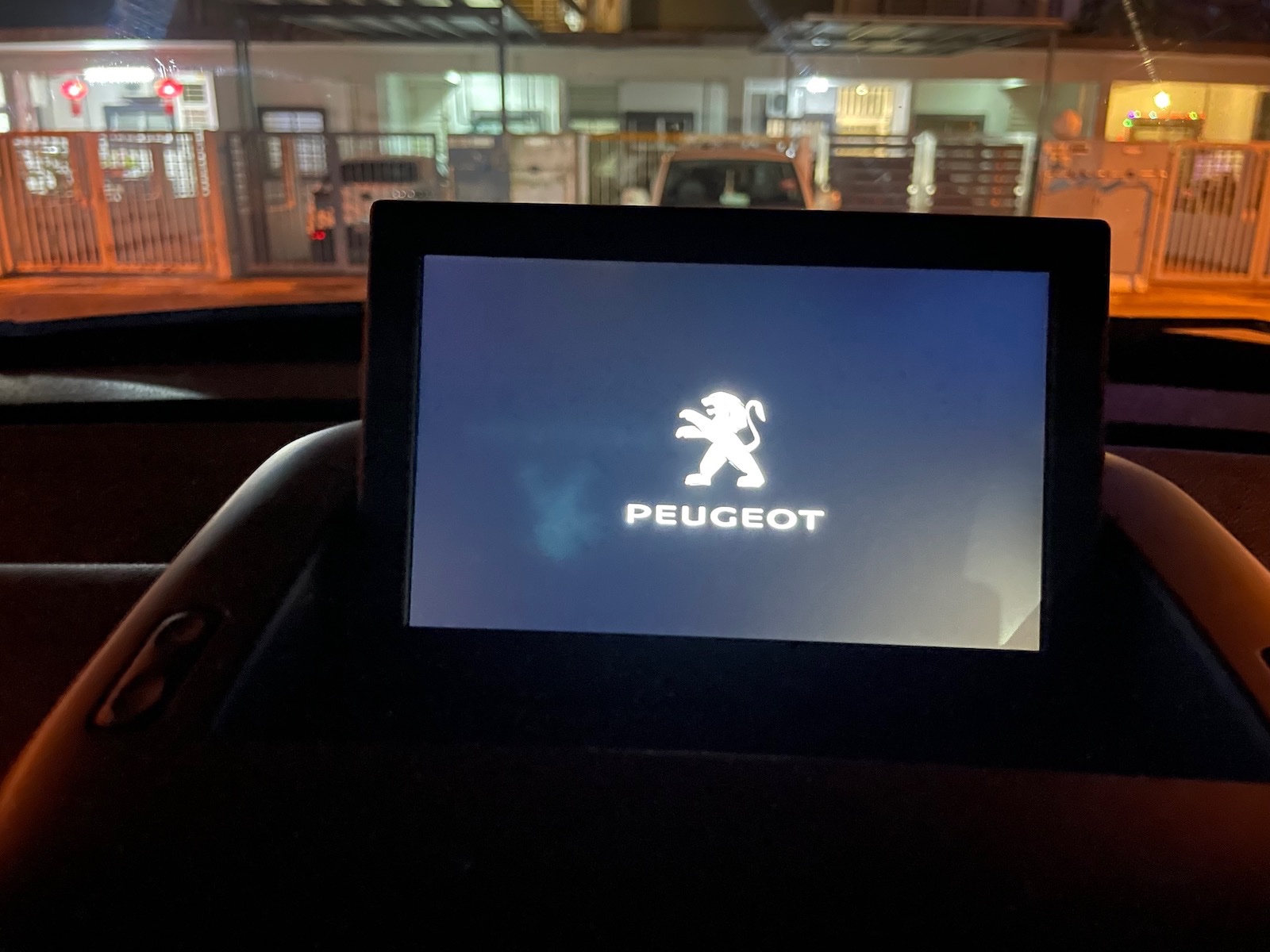

- Slow booting. Upon power on (key on), Logo appears. After 1 minute logo is still on the screen but the radio sound is audible. After about 2 minutes then the Radio screen is displayed
- Intermittent restart. Sometimes it works fine for about an hour or so during driving. Sometimes rebooted several time within 10 minutes time. Happens no matter what the weather is like.
- Today, I got a whole white screen about 50% transparency. I can only see a very faint text of the elevation and satellite number below the screen. (first time happened to me). Pressed the eject button to reboot and it starts to radio screen.
From the reading in the internet and FCF forums, I suspected the SD card has started to be funny. I'm very technical and able to do electronic repairs and computer programming. If there's anything that you can suggest, I might be able to try it.
Will try the BSI reset tomorrow morning.

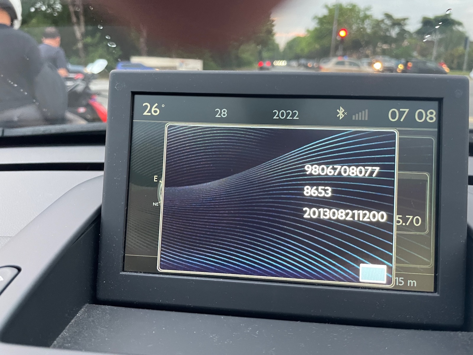

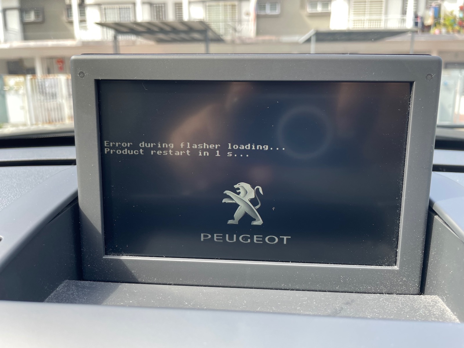

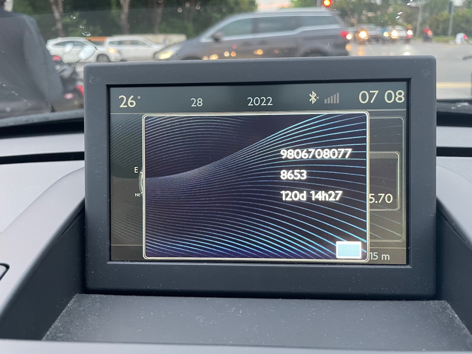

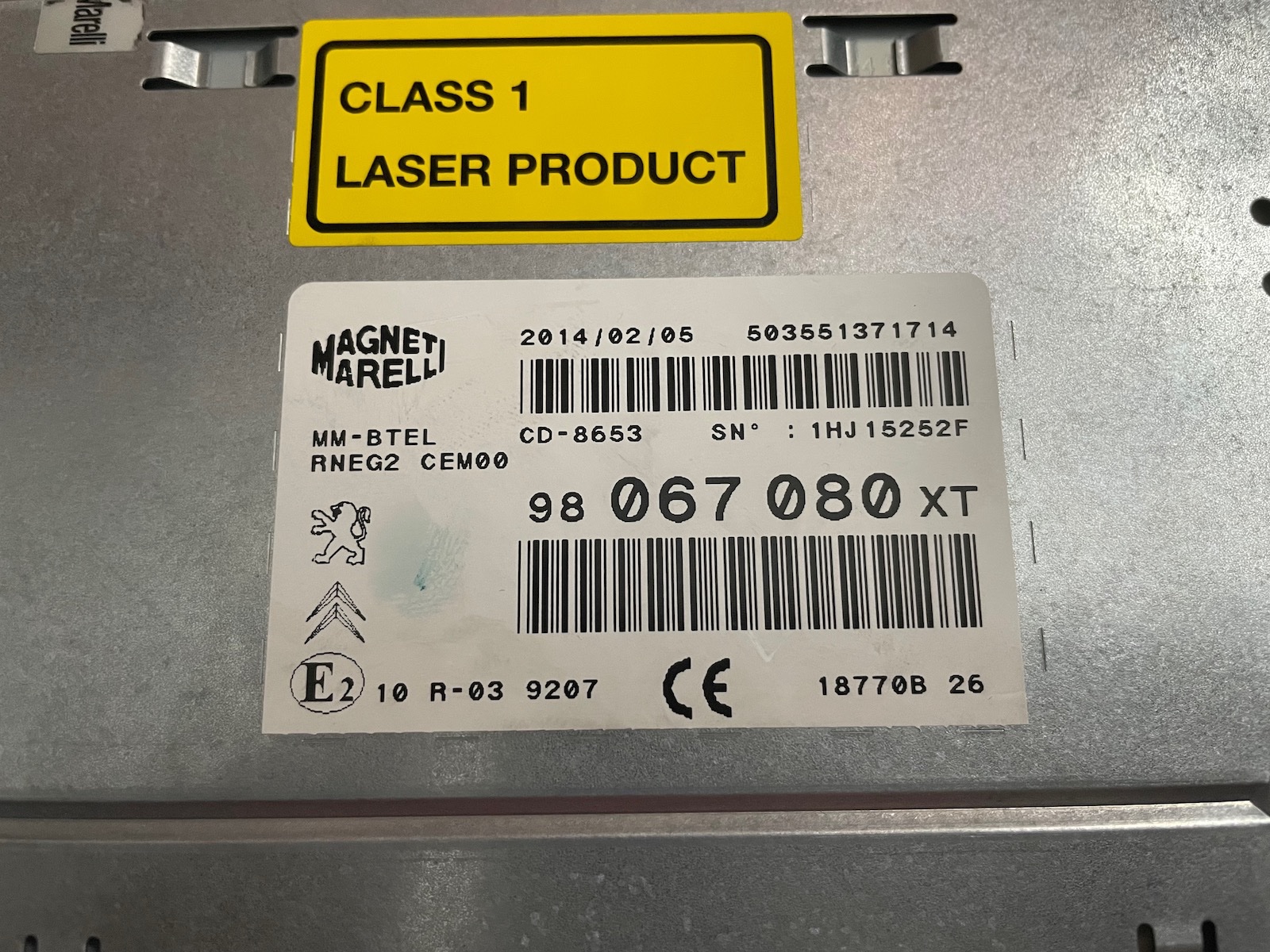

Hi Marc,
Sorry for the delay as I'm away on work.

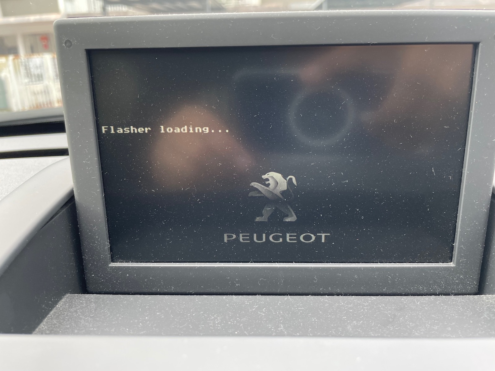

I have tried to replace the SD card and try to install the firmware. I manage to get some text on the screen then a Disk Check and error.
I tried using several CD, several USB drive, but still I got the same error.
By the way, I manage to get the serial and maybe model number / version from the unit, if that helps.
As of now, I have no other way to restore the firmware except cloning the old SD card. As I type here, the cloning is in progress, but it looks like there will be issues as well because the old SD card has a lot of bad sectors and unreadable. I'll let it finish first and will check tomorrow morning.
By the way, is there a manual way of installing the firmware (e.g. manually copy the files from the ISO and put into the new SD card partition)?
- Dinas -
- Dinas -
- x 6946
Hi Dinas
I don't know what else I can add.
If you are sure you have formatted a decent branded USB with FAT32 and have not used a MAC do do it and ensured there are no additional files on the USB, I'm not sure where to go from here.
These errors may be related to the source files / corruption or the media. It seems top be having an issue loading.
You can't manually copy the files, that won't work as it is a process that has to be followed internally during the update.

I'm using a 16Gb Kingston CANVAS Select PLUS, fresh from a new pack, and put it straight into the RT6. It's very hard to get 16Gb SD card now and even worse with the 8Gb.GiveMeABreak wrote: 17 May 2022, 17:51 If you are sure you have formatted a decent branded USB with FAT32 and have not used a MAC do do it and ensured there are no additional files on the USB, I'm not sure where to go from here.
As for the installer media, I'm using Nero burner to burn the ISO directly to a CD-RW. I even tried using USB drive and make sure the Volume Information folder is deleted before plugging it into the RT6, but still I got the same error.
On the other hand, my cloning of the first 152Mb partition went very smooth. For the second 152MB partition (the one with the APPLICATION folder inside it) there are 11 bad sector which can't be copied. The last partition with the MAPPE folder also cloned successfully without errors. I will try with this SD and see what's the outcome.
