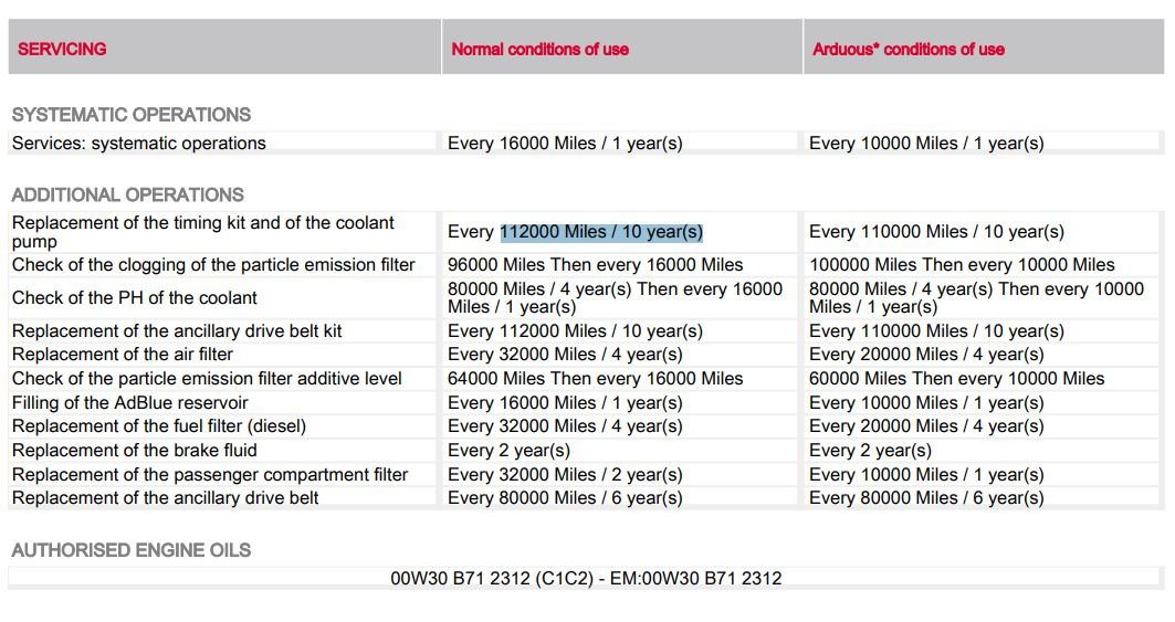

Hi, if this is for your Picasso VIN ending in 258, then the timing belt service for 'Normal' driving conditions is 112k miles or 10 years, whichever is the soonest, and 110K miles for 'Arduous' conditions / countries.
Here are the other operations specific to your vehicle and the recommended engine oils in case you need them:

Thank you. I'm currently on 91k miles. Will change mine before 100k. Better to be safe than sorry.

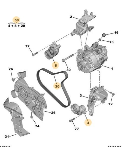

The Ancillary kit is part: 1631481680, £198.05 inc. VAT, shown as item (50) below:
If Timing - I already answered this above:
The ancillary belt comes separately or as a kit.GiveMeABreak wrote: 26 Apr 2022, 14:55 PSA offer kits for most vehicles that include the belt only, the belt and pulley tensioners or the belt, the tensioners and the water pump.

On the service interval info you posted it states ancillary drive belt 80k and ancillary drive belt kit at 110k - I was wondering what you get in the kit in addition to the belt?
Am I right in saying you change the belt at 80k, then again 30k later, with the ancillary drive belt kit? Or have I misunderstood it?
- x 6956
Re: Timing belt interval for c4 picasso bluehdi eat6 1.6?
Basically they are saying the belt should be replaced at 80K, but the pulleys / tensioners shown at (4) & (5) at 110k,
So if it was me, when I change the belt say at 80K, I would be replacing the whole lot using the kit which includes the items shown as (50), then forget about it, as you'll often find doing so eliminates squeaks and rattles.

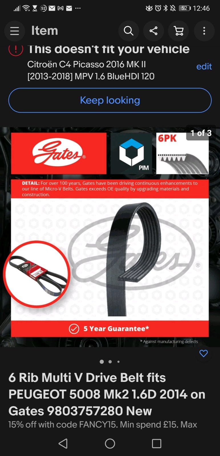

I bought the ancillary belt kit 1631481680 from a seller on ebay. They've supplied the kit with belt 9803757280 -could you check if that is that the correct one for my car please? Ebay says that isn't compatible with my vehicle. A bit worried they've sent the wrong thing!GiveMeABreak wrote: 30 Apr 2022, 16:15 It's a pig of a job by all accounts as apart from needing the locking pins for the camshaft , the high pressure fuel pump drive pulley and the crankshaft the left hand engine mounting needs removing so the engine / gearbox assembly needs supporting, so any trolley jack must be able to support the weight.

1631481680 is the ancillary belt kit, which is item (50) as per my diagram that includes the belt plus the alternator tensioner and dynamic rollers, not just the belt.
The belt on its own is 9803757280 and that is correct for your vehicle.
You have probably entered the incorrect vehicle details on their website and it's another reason why the staff only use official data from the manufacturer based on your VIN.
