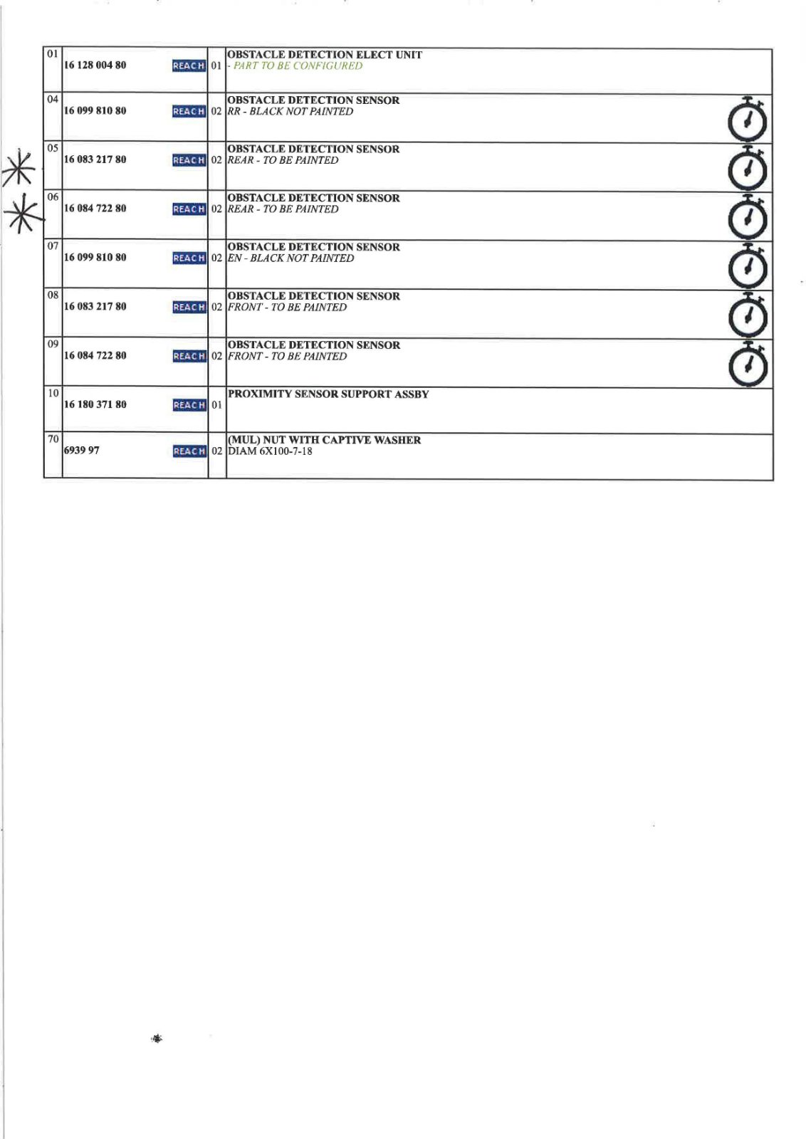

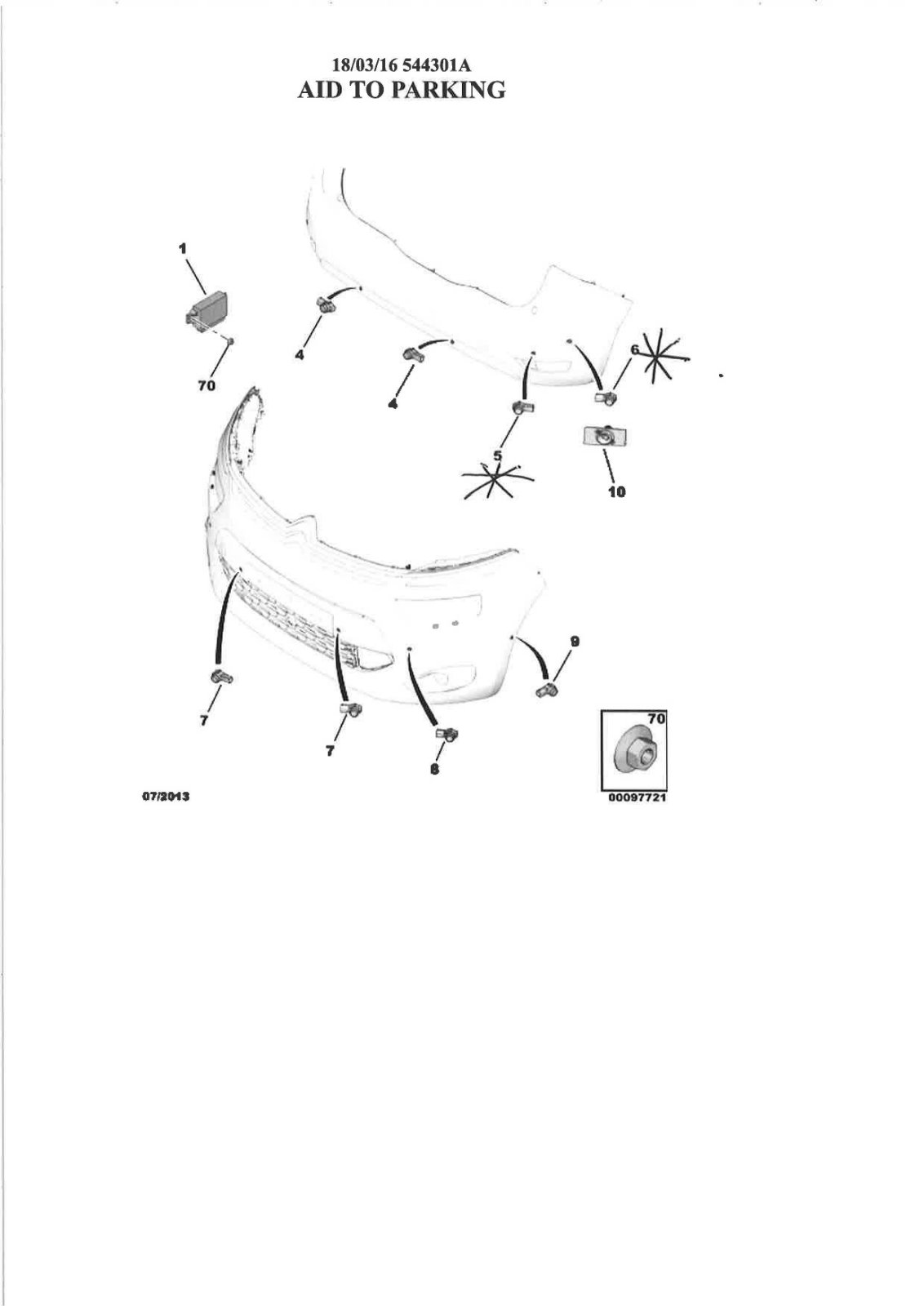

After almost a year of no work on my Parking sensors, I found a replacement sensor to cure the second sensor from the left - LEFT OUTER SENSOR (fault code B1224), even though I had previously swapped this with the same sensor on the right side, with no positive result (makes the cabling suspicious), and I fitted it today - NO CHANGE.
Further investigation suggests that my TopDon Diag Box is confused over which sensor is which. Or I can't read Chinese "Engrish" (please forgive the weak joke.
I have attached the PSA paperwork, showing the part numbers and positions of the 6 sensors on each end of the car - please check for the indicated positions of 5 & 6.
Position 5 (16 083 217 80) is the Outer Rear Left Parking Assistance Sensor - Fault code B1224 this is the indicated fault code
Position 6 (16 084 722 80) is the Rear Left Lateral Parking Assistance Sensor - Fault code B1244
My Diag Box says the fault is DEFINITELY B1224 - the second sensor inwards from the extremity, but when I inteerogate it, the diag box says this sensor is responsible for (parallel)Parking and steering assistance. I don't believe this is correct. Can anyone verify or confirm the correct sensor positions regarding the failure identity, as I have swapped both from side to side (they are not interchangeable from 5 to 6, and the connectors have different keyways.?

First, you are missing the last 2 digits of the fault code - which will tell me what the specific issue is with it. Your fault code reader most likely can't provide this, so I can't help you with the exact problem being reported. Ideally Diagbox should be used.
Second, ignore the parts diagram you posted up - those are irrelevant as far as positioning goes. The 5 & 6 on the parts list are not positions, they are items on the diagram and therefore the part numbers are not relevant. The sensors for the inner, outer and blindspot monitoring are all different.

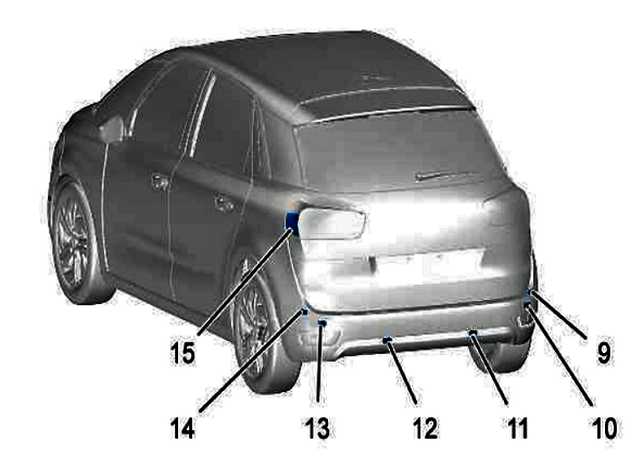

So for Fault B1224, it is referring on my diagram to sensor (13).
Fault B1244 is referring to sensor (14) - which is the rear left Blindspot proximity sensor.
Ok there are several things to understand about the various systems:
Normal Parking assistance
The 4 Front inner most and the rear 4 innermost sensors are used for obstacle detection for normal non-assisted parking.
Blind Spot Monitoring
The Blind Spot monitoring system uses the outermost front 2 and rear outer most 2 sensors to detect vehicles passing and illuminate the diode in the relevant wing mirror.
Semi Automatic Parking
For this system, all 12 (6 rear & 6 front) sensors are used to park the vehicle, along with the reversing camera / side cameras depending on equipment.
Front
(1) Electric power steering.
(2) Steering wheel angle sensor.
(3) Front parking space measurement proximity transmitter sensor (left side).
(4) Exterior left front proximity transmitter sensor.
(5) Interior left front proximity transmitter sensor.
(6) Interior right front proximity transmitter sensor.
(7) Exterior right front proximity transmitter sensor.
(8) Front parking space measurement proximity transmitter sensor (right side).
Rear
(9) Right-hand blind spot monitoring proximity transmitter sensor.
(10) Exterior right rear proximity transmitter sensor.
(11) Interior right rear proximity transmitter sensor.
(12) Interior left rear proximity transmitter sensor.
(13) Exterior left rear proximity transmitter sensor.
(14) Left-hand blind spot monitoring proximity transmitter sensor.
(15) Semi-automatic parking assistance ECU.

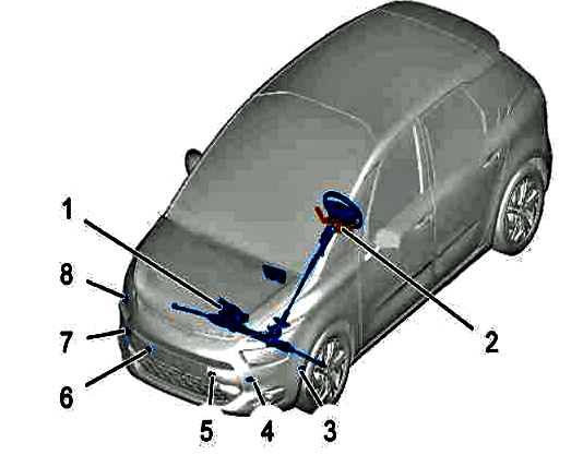

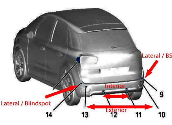

As for the positions and names, let's refer to my 2 diagrams:
The blind spot sensors above (3 & 8 and 9 & 14) are referred to as front or rear, left or right hand 'blind spot monitoring proximity sensors', but also can be referred to as the front or rear lateral sensors.
The inner 2 front (5 & 6) and inner 2 rear (11 & 12) parking sensors are referred to as 'interior'.
The outer 2 front (4 & 7) and outer 2 rear (10 & 13) parking sensors are referred to as 'exterior'.

Thanks very much for your response, Marc.
Your positional numbering, although different to what the PSA drawings showed indicate the same sensors I was querying, so at least I now know I'm chasing the right fault location.
I don't know how to get to another 2 digits of identification on my TopDon box, but it does show a deeper analysis on live request, so I'll carry on from here. Having previously swapped sensors left to right and back again with no fault identity change, I guess, I'm going to have to remove the bumber and check the cabling.
If I manage to find a deeper fault analysis, I will post the details.
Thanks again
WillyR
Thanks again

The last 2 digits of the fault code will indicate what the issue is with the sensor - i.e open circuit, short circuit etc. and each of these can have 3-4+ variations of fault Willy.
Also please bear in mind that the sensors are different depending on the position (inner, outer & lateral or Blind Spot) so changing any of these with a different type may throw another error that you don't need when troubleshooting.
https://www.easydiagnostics.co.uk/produ ... t-vehicles

Just so we are on the same page:
As for the Blindspot issue - I can't say if there is a fault - but the front and rear work together on each side. If you had a fault with the Blindspot sensors (any of them), you would have a warning lamp on the dashboard light up and possibly a message.
So without the full fault code I can't advise as to what the problem is.

That is even clearer than before, and I promise faithfully to NEVER mix them up again.
As you previously said, and the PSA diagram I posted indicated, there are two each of three different sensors (PSA part numbers shown for 13/14 & 9/10), front and rear. I have decided to go down to my local scrappy and see if he has a Picasso II in his lot, and purloin the wiring loom for the rear sensors. Right now, I am very sure all 4 of the exterior rear sensors are OK, and the wiring to No 13 is not good somehow, because every swap has retained the fault at No 13 - swapped 13 & 10, and also fitted a new No 13 - irrespective of the sensor fitted in that position.
It will probably be a few days, at least, before I post again as chasing the wiring, as I'm sure you know only too well, is not the most fun in the circus.
Cheers for Now
WillyR
