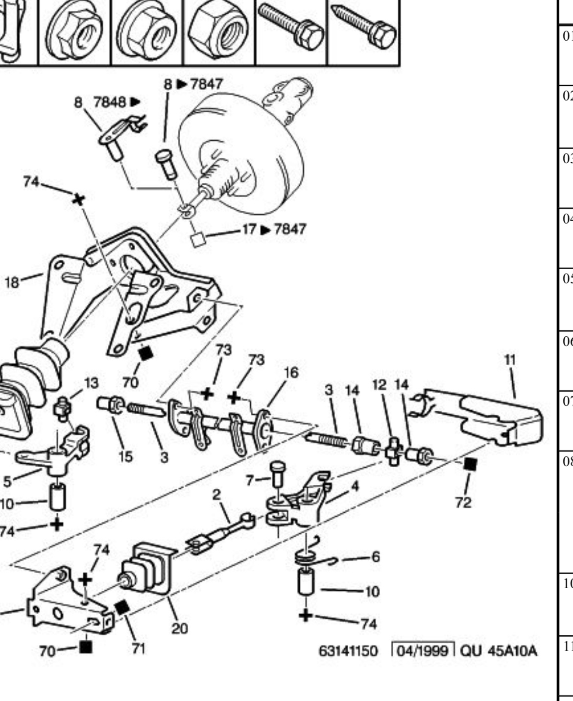

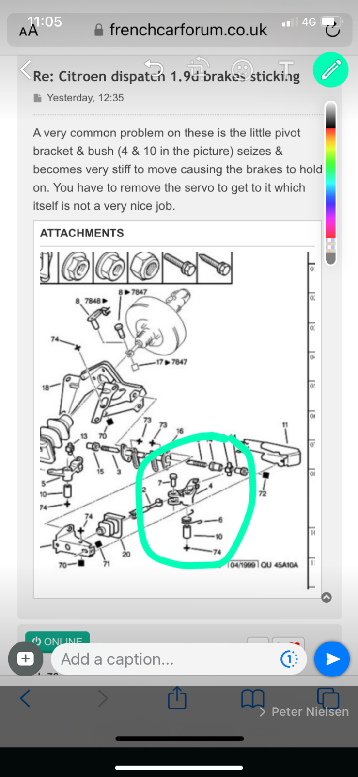

A very common problem on these is the little pivot bracket & bush (4 & 10 in the picture) seizes & becomes very stiff to move causing the brakes to hold on. You have to remove the servo to get to it which itself is not a very nice job.

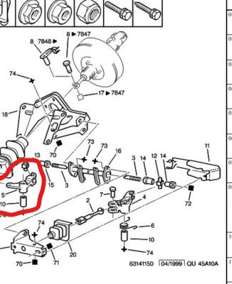

Is just this 4&10 pivot n bush and is this behind the brake pedal ?

Sorry, my mistake, its actually 5 & 10. I didnt realise there is an almost identical pivot on the pedal side. The bush in the bracket is the same part though.
It is located behind the servo in the engine bay. Removing the servo on this van is an engine out job, well you at least have to drop the engine & gearbox down off its mounts & support it on an engine lifting table.

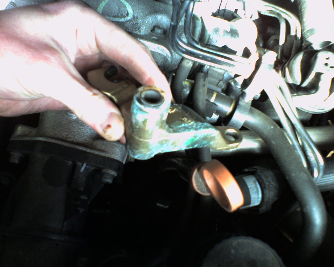

Just for reference here is the part that causes the problem, this was one i done on a C8 (same setup as the Dispatch) a few years back, Picture isn't great as it was taken years ago on a really old camera phone. The insert in the middle just seizes up in the pivot & goes really stiff. I notice the part number of the bush insert has been superseded to a new number so it may be modified now?
Dont know how well you would get into it to lube it in place apart from some blind spraying.

I see what you mean by the photo I’ll try and blind spray it’s difficult to get to the back of the servo on the dispatch, there is no play once the servo is unbolted to get a hand in to the linkages,
