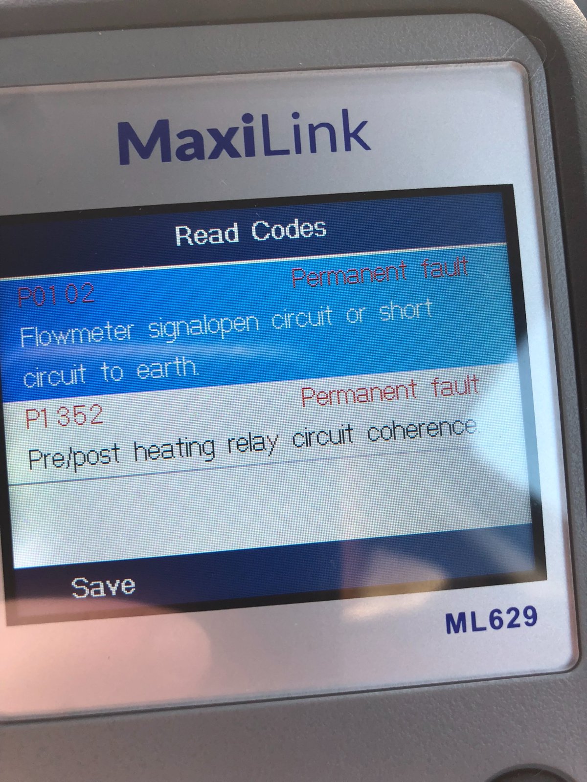

Recently I have been plagued with a likely MAF related issue
Code:
P0102 - Flowmeter signalopen circuit or short circuit to earth
Symptom:
This issue causes an anti pollution message in the cabin and then seems to limit the revs to 3000 very slow and no power it is almost always on at the moment.
