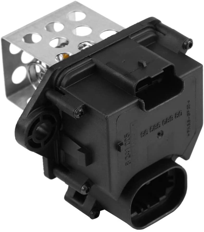

Re: DS5 Cooling Fan on Constantly
Unread post by JimDude »
This is it.

Are you meaning the engine cooling fan or the climate control fans? Because if that is the part £18 isn't bad at all and it might be what i need for DS4
JimDude
Posts: 4
Joined: 19 Apr 2022, 09:16
x 2
It's the thermostat on the engine cooling fan in front of the radiator.
