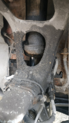

What causes this?
https://flic.kr/p/2neB8qq
I had the CV boot changed a few weeks ago, didn't drive it since, jacked it up today to change the bushing and saw the leak.
The outside sleeve looks pushed up, is this fixable or is it new strut time?
Also is something bent which could have caused it to push up?

New strut time.
The boots are bonded. It looks like the boot has been caught and ripped off the strut either as a result of damage from the previous work or may be unrelated - hard to say. If the boot has been caught and pulled off, it may have damaged the strut - or the strut has developed a leak and has hastened the boot's departure. These are not repairable and requires a new strut to be fitted.

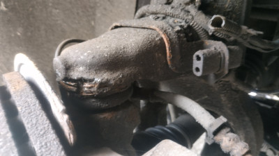

Is this bad?
Is this bad?

GiveMeABreak wrote: 15 Apr 2022, 12:47 New strut time.
Some pics of another member's strut:
viewtopic.php?t=62669&hilit=strut
Thanks a million for that, now I don't feel that bad, I was annoyed because I thought the guys who did the CV boot messed it up, but if it's possible for it to fail like that, then that's my fault for buying a C5 X7 with badly designed shocks and a bound to fail steering rack.
