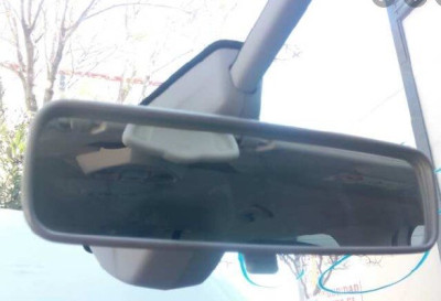

I'm thinking of replacing my OEM rear view mirror with an aftermarket one that has built in dash cam / reverse parking camera.
At present I'm using a Halfords dash cam that is suckered on to my windscreen & i don't have a rear parking cam on my vehicle so I'm thinking of this upgrade. There's a few I'm looking at, but what I'm not sure about is the fitting that the OEM rear mirror uses, is it a standard fitting or is it not straight forward to replace with a different mirror?
This is my VN: VF7**************[VIN obfuscated, can be read by forum staff]
here's what my current mirror looks like at the moment:
Any info much appreciated, thanks :)

Obviously we can't comment on aftermarket mirrors here. Just don't tap into any existing multiplexed wiring of your vehicle or you can end up with equipment fault on the data networks.
Always wire aftermarket equipment in separately to the passenger fusebox if you can using a piggy back fuse. Obviously, in this case you may need to tap into the reversing light wire. You'll have to consult the kit and work out if it is compatible.
Installation is going to take a while as you'll have to safely route the wiring from the front to the rear and avoid routing any wires where you have airbag deployment, which includes the side curtain airbags! Avoid wiring here as if they go off in an accident and the dash cam wiring comes loose and gets in from of the airbag curtain, it will act like cheese wire and can potentially cause a fatality to passengers. Always try and route cables along the floor under carpets and lower floor trim panels through to the rear where there are no airbags.
Also be careful of the A Pillar as the side curtain airbag control wires may likely extend into the A Pill section.
